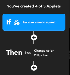

Step 1: Changing Smart Lights With IFTTT
IFTTT is a very useful app standing for IF This Than That. Essentially you can create a trigger and make an action happen when that trigger is triggered
You do NOT need to pay for an account to use this
Here are the steps to make your applets
- Create/Log in to your account
- Hit "Create" on the bottom bar
- Add a trigger under the "If" section
- Click the "Webhooks" trigger
- Click "Recieve a web request"
- Pick your Event Name
- You will be creating 2 triggers, one should be named something along the lines of "Turn_Lights_Red" and the other should be named something like "Lights_Back"
- Hit "Create trigger"
- Add an action under the "Then That" section
- Click the Phillips Hue section
- Click "Change Color"
- Connect account
- Select which lights you want to change
- Add the color codes(For the change to red use #FF0000 and for the other one change it to the color your lights are on usually)
- Click "Create Action"
- Repeat to make the other trigger

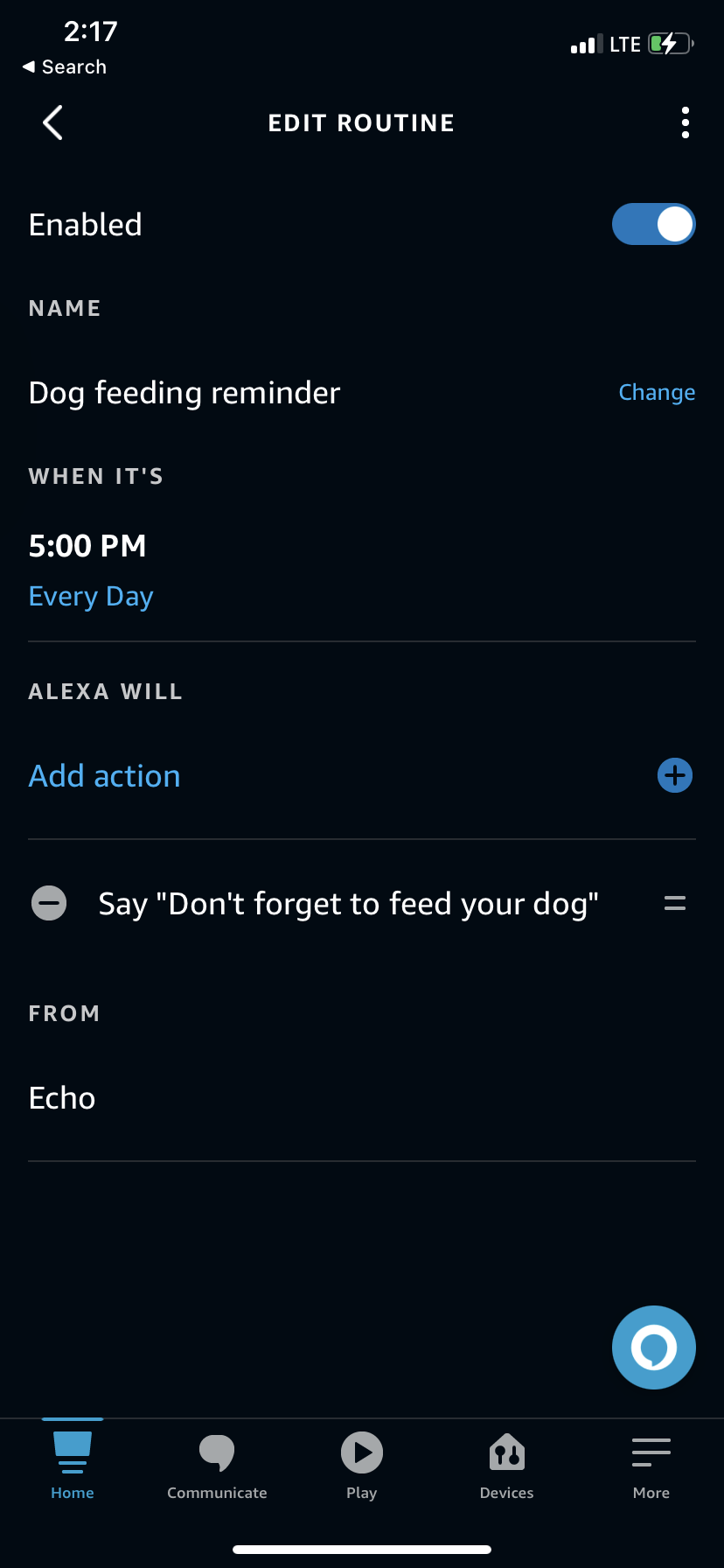

Step 3: Set Up Reminders With Alexa
With your alexa, you will be able to be reminded in a 4th way as well as use your voice to say that you have been alerted
After opening your Alexa app you need to
- Hit routine
- Create a new routine
- Name your routine
- Select the input
- Hit Date & Time
- Set it to be every day at the time of your choosing
- Select the action
- Click "Alexa Says"
- Set a reminder to be said every time you get alerted
Alexa will now say your message every time it is time to be reminded

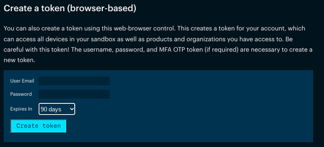

- Go to https://docs.particle.io/reference/cloud-apis/access-tokens/
- Create your access code using the browser based method
- Plug in your information into the following webhook
- https://api.particle.io/v1/devices/{ID}/alerted/?access_token={ACCESS_CODE}

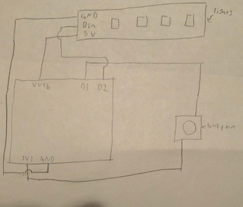

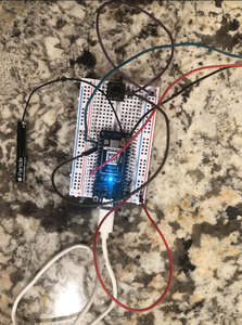

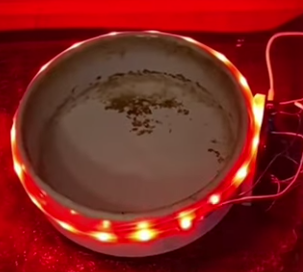

Step 6: Wiring the Breadboard
Grab your breadboard and attach the wires according to the diagram above or the bullet points below
- Button
- Place your button in some place on the breadboard
- Attach one of the legs to the 3v3 pin
- Attach the opposite leg to the D3 pin
- Lights
- Make sure you plug this part in while the argon is not connected to power
- Solder a wire to each of the neopixel copper pads
- Attach the neopixel GND pad to the Argon GND pin
- Attach the neopixel Din pad to the Argon D2 pin
- Attatch the neopixel 5v pad to the Argon VUSB pin

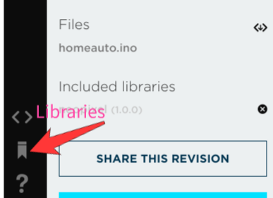

Step 7: Changing the Code to Fit Your Needs
Take the code in one of the ways found below and copy it into https://build.particle.io/build/new
- Go to the "Libraries" Tab
- Add the neopixel library
Line 4: Change the PIXEL_COUNT variable to the number of pixels on your neopixel strip
Line 5: Change the PIXEL_TYPE variable to the type of your neopixels if not WS2812B
Line 10: Change the preset variable to the number you want your argon to default to upon startup
- This can be changed through the button so don't stress on this line too much

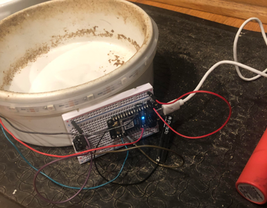

Step 8: Using Your New Notifier
Congrats on making your Notifier, here is how to use it

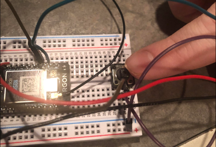

When the lights are on, hit the button to turn them off or use alexa(how to do this is shown in step 5)
When the lights are off, hit the button to change the preset

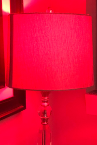

- Preset 1: 1 red light going around
- Preset 2: 1 random color light going around
- Preset 3: 2 red lights going the opposite way
- Preset 4: a loop of red, then blue, then green lights
You can see the presets in action through the video below
