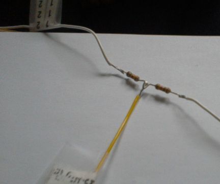

Step 2: Prepare Voltage Divider As Follow
- Solder 15k and 10k resistors together.
- Solder an wire same place where you solder the two resistors
Usage: 15k resistor free end will be input from sensor, 10k resistor free end will be ground connected to Arduino GND pin and external power supply GND; middle wire will be output to Arduino digital input pin (D2 in my case)
Step 3: Connect Sensor to Voltage Divider and Power Supply
- Connect sensor positive cable (brown in my case) to 10-30 V power supply
- Connect sensor negative cable (blue in my case) to power supply ground
- Connect sensor data cable (black in my case) to 15k free end of voltage divider.
