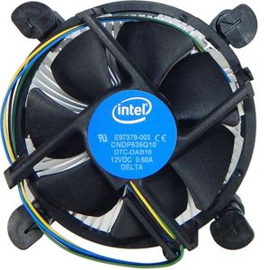

P2 is a 3-pins XH male connector that is used to connect the Fan(s) to the board. Q2 is used to transfer the PWM pulses to the control pin of the Fan. R2 is a 10K pull-up resistor that shifts the 5V PWM signal level to 12V. R3 is a pull-down resistor to avoid unwanted triggering of the gate pin of Q3. Figure 2 shows a typical Intel CPU Fan which could be one of your options to cool down the components, using this controller board.
Step 2: Figure 2 an Intel CPU Fan Which Is Cheap Enough to Be Used for Cooling
