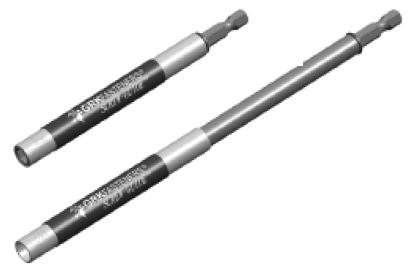

Me and a friend were talking about auto feed screw guns and how they were huge and expensive. I have not got as far as to make this auto feed but it is why I used the circular bottle for later fabrication of auto feed. I am close with trying to build a drum style hand held auto screw gun to hold and dispense 8 screws (for the everyday home user) This Idea is more like a simple one screw at a time Idea that covers 3 tools you can buy in the store. I have designed this to be a "screw guide" like the tool you can buy that has the sheath to hold the screw while drilling. Also I have made it so it will drive a flush screw every time and self retract, no matter what size the screw. Also I have designed it around a magnetic "fast change" bit with bearings to independently spin.so in seconds can go from Philips to Flathead. Everything in this project is recycled or something I had laying around the house. The only thing I did pay for was bearings and inner/outer race so I could make the outside hand held part free floating. If there are any questions about this project I'll be more than glad to answer them. I do things a little differently than some, When I build I do it the same way I play instruments. I don't know the chords or sheet music and I play everything by ear so you will find in this project I really didn't measure anything or plan anything out so I will do my best to explain my trial and error tactics and how I got what I ended up with. I do apologize for that.
