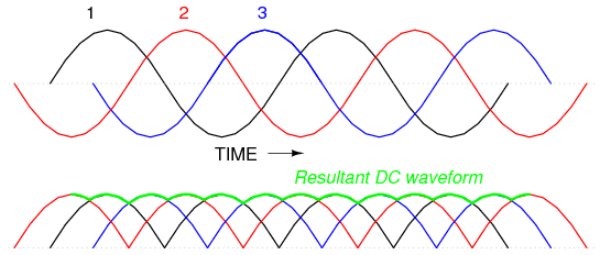

Basically a rectifier eliminates the negative cycle of AC, so by principle we can get a much better result if we do rectification another time. There are two basic types of three phase rectifiers, 6 pulse rectifiers and 12 pulse rectifiers. Both of them are shown here below.

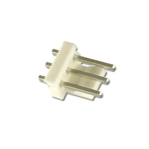

- Connectors

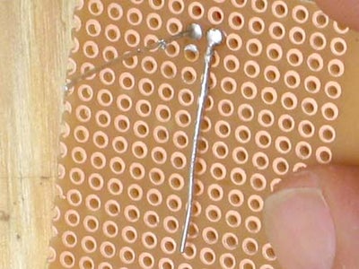

Step 2: Putting Them Together
Basic soldering is needed here. Just solder the circuit all together. This is simple enough and only basic skill level is required.

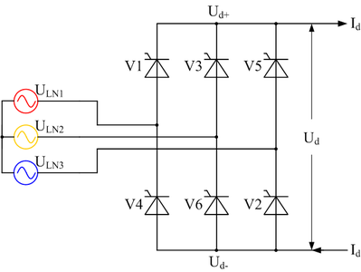

Step 3: 6 Pulse Rectifier
For an uncontrolled three-phase bridge rectifier, six diodes are
used, and the circuit again has a pulse number of six. For this reason, it is also commonly referred to as a six-pulse bridge.
For low-power applications, double diodes in series, with the anode of the first diode connected to the cathode of the second, are manufactured as a single component for this purpose. Some commercially available double diodes have all four terminals available so the user can configure them for single-phase split supply use, half a bridge, or three-phase rectifier.

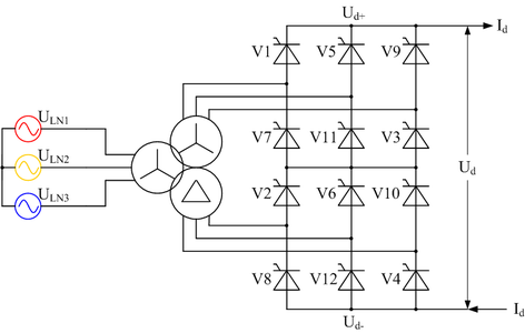

Step 4: 12 Pulse Rectifier
Although better than single-phase rectifiers or three-phase half-wave
rectifiers, six-pulse rectifier circuits still produce considerable harmonic distortion on both the AC and DC connections. For very high-power rectifiers the twelve-pulse bridge connection is usually used. A twelve-pulse bridge consists of two six-pulse bridge circuits connected in series, with their AC connections fed from a supply transformer that produces a 30° phase shift between the two bridges. This cancels many of the characteristic harmonics the six-pulse bridges produce.
The 30 degree phase shift is usually achieved by using a transformer with two sets of secondary windings, one in star (wye) connection and one in delta connection.
