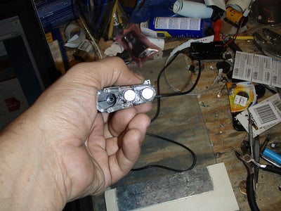

heres a medium-resolution usb microsope i made for under $100 in parts (if you bought them new), had most of this around already and made a new tool :)
parts:
1 radioshack pocket scope
1 white led
1 logitech notebook pro quickcam (zeiss lens)
30 awg wire
heatshrink or black tape
hotglue gun (or whatever appropriate glue your prefer)
(cheap plug) http://www.makenyc.org/
Step 1: Modify the Microscope
this is pretty easy, the microscope comes with an incandecent bulb which is normally powered by 2 1.5v AAA batteries, just rip these all out and replace the light with a single white LED and extend its leads up through the case using the 30awg wire..
use your heatshink/tape here to insulate the leads.
test your light with a battery and make note of which lead is the anode/cathode.
on the camera board there is a small (freaking bright) orange led, *carefully* remove it, and wire the leads from our white LED in its place, with this camera the LED is under software control, usb provides all the power. make sure these leads have plenty of slack.
be generous with the hot glue to help act as strain relief on the wires; also be careful positioning the white led so that it points generally where the camera lens points

ok, if you have the led wired in well put the microscope back together (you didnt lose those screws did you?)
next remove the little rubber bit from the microscope eyepiece, notice that that inside edge of the eye piece has a graduated cone shape, this will help the camera fit square on, it might even help to do this with the camera connected so you get the camera mounted to the microscope nice and square.
a nice ring of hot glue around the remaining microscope will help mount the lens of the camera to the microscope eyepiece without getting any glue anywhere near the lenses.
Step 4: Make a Base
so, now this thing is really really lite, so i glued a couple neodymium magnets to the bottom and created a wood base with a chunk of scrap metal on it.
the idea here is that the magnet will easily slide but otherwise wont move; which is an otherwise frustrating problem with tiny tiny things..
