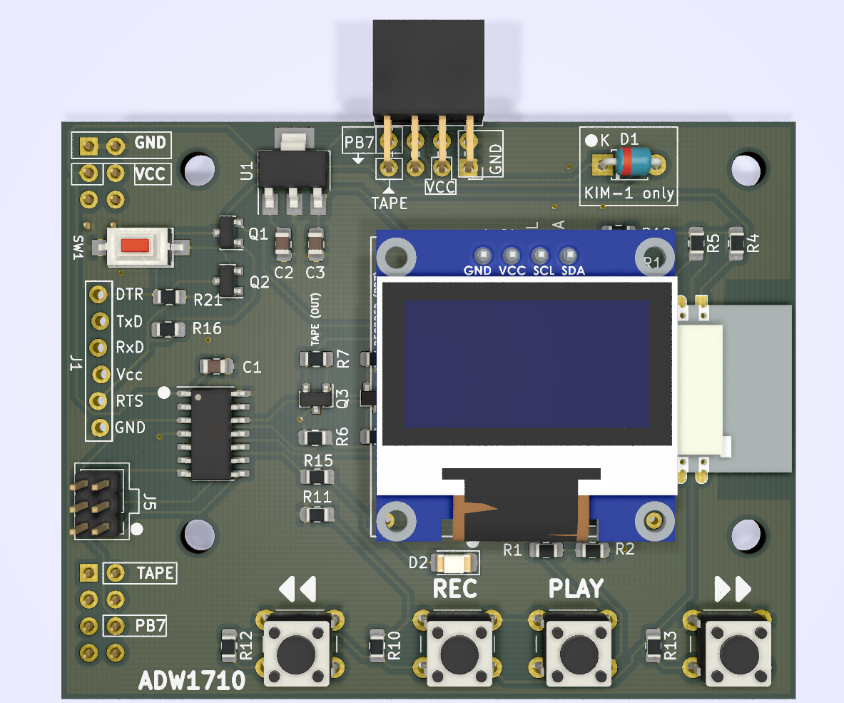

The board fits on the micro-KIM expansion header and you snap the digital Tape Recorder to the Memory Expansion Board to make it one. The memory Expansion also fits the PAL-1 (a micro-KIM clone).
Read all about it on my website.
