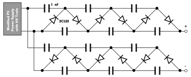

For driving Cockroft Walton Multiplier I use stable high voltage source which I made with minimal modification of the old PC power supply. With this setup I achieved a constant spark from more than 30cm and a periodical sparks at a distance of more than 35cm.
  1. HV diode 2CL25 - 25 kV/20 mA x 30
  2. 1nF/30kV Capacitor x 30
  3. Modified PC Power Supply
  4. HV Trafo from old CRT TV

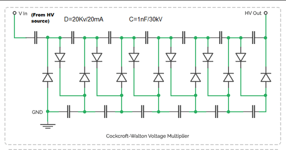

The Cockcroft-Walton voltage multiplier is a circuit configuration used to generate high DC voltages from a low AC voltage source. The basic Cockcroft-Walton voltage multiplier circuit consists of a series of capacitors and diodes interconnected in a ladder-like configuratoin. The circuit takes advantage of the fact that capacitors charge and discharge alternately when connected in series with diodes. It's typically used in applications where a relatively constant output voltage isn't required, as a laser systems, X-ray systems, air ionisers, cathode ray tubes etc...
A standard cocroft-walton multiplier uses one ladder stage and the multiplied voltage is generated between the last segment and the input or ground.
In order to increase the voltage and thus the length of the spark, I will connect the HV Transformer to drive two cascades of opposite polarities at the same time.
Step 2: Parts and Mounting
The elements of the cascade are mounted on Plexiglas with a thickness of 3 mm, which is also an excellent insulating material. The capacitors are mounted on the front and the diodes on the back of the plexiglass. Now at the end of one cascade prevail negative ions(Kations), and at the end of the other positive ions(Anions), so between these two differently charged electrodes a spark appears.

Unlike then, this time I increased the number of both cascades, but in order to get a constant spark at the output, a stronger input source of high voltage is also needed.
Step 3: PC Psu to High Voltage Source
For this purpose I will use the device also made in one of my previous videos in which it is described how to make an excellent stable high voltage source with minimal modification of the PC power supply. In order not to repeat ourselves, you can watch the video on the manufacturing method at the given link above. In this way, the device itself becomes more compact, it works stably, and there is no unnecessary wires under high voltage.

As you can see in the video, And all this is achieved in air, without the use of various oils for insulation. As far as I could find online, there is no one else who has managed to create such a large spark without using insulating fluids. In order to ensure the reliability of the results, I put a ruler tool on the table on which the device is placed so that the length of the spark can be clearly measured.
These spark lengths in air correspond to a voltage of approximately 300-350 kilovolts
