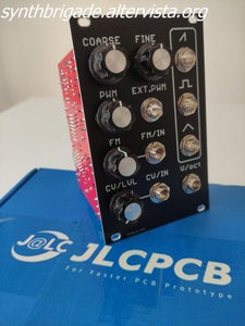

The PCB I layed down has all the possible inputs and outputs the CEM3340 can handle: frequency control (coarse and fine), three waves outs, soft and hard sync inputs, a CV for V/oct input, a secondary, linear control voltage input, FM and PWM inputs and level control.
Each input/output has a "live" connection and a ground connection. By daisy chaining ground terminals directly on panel components, a single cable to ground will suffice (see the attached picture).
This design is optimized for a +/-12V dual rail power supply, which is the optimal to keep such a chip as cold as possible.
Wave outs are in the 0-8V range (see attached pictures), but I have also placed three optional electrolitic capacitors (C12, C13, C14) in series with the wave out to eliminate the DC offset as per eurorack standard. If you want to leave the three capacitors out, take care of shorting the two terminals directly on the PCB. The important thing to remember is that without a jumper (or a capacitor) you will have no wave at all!
Components values are directly silkscreened on the PCB, which will make the assembly way easier than consulting a reference sheet.
The circuit is protected against polarity invertion between +12V and -12V and has both high frequency and low frequency filter capacitors at the input.
The circuit board is intended to be installed perpendicular to the panel. See next step for details ;)

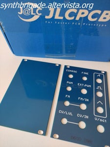

Step 2: The Panel Board
In a previous Instructable I showed you how easy and convenient it is to use fiberglass panels in place of the most common metals panels.
In that article I shared with you gerber files for 3U tall, 4HP, 6HP, 8HP and 12HP blank panels. For this project I was in the need for 16HP panels, so I layed down both a blank panel and a pre-drilled panel with adeguate silkscreened text.

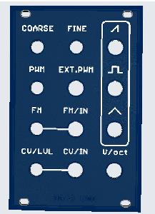

Being that the panel dimensions are limited, I had to take some decision on what inputs/outputs to include and what to leave out. Using 1/4" jacks in place of the most used 1/8" has it's pros and cons. The main cons is for sure the amount of space required for every single female jack. In order to avoid clumping too many connectors toghether, the pre-drilled front panel includes:
- 3 waves out (triangle, square and sawtooth)
- 2 frequency control potentiometers (coarse and fine)
- FM and PWM potentiometers
- FM and PWM control voltages inputs
- V/oct input
- a secondary CV input
I basically had to leave out all the sync inputs. At some point I thought to use a three poles rotary selector to switch between waveforms and save a "slot" to include at least one of the three sync options. Then I realized that having all three wave outs in conjunction with a mixer could lead to an interesting variable waveshape (like Arturia did with the Minibrute) so I aborted the idea.
Holes are spaced 1.05" in the vertical direction, which is the exact spacing between PCB mounted potentiometers. Holes for potentiometers have a diameter of 0.32 inches; holes for 1/4" female jack have a diameter of 0.38".
As said, I use 1/4" jacks in my synthesizer, so panel's holes are too big if you use 1/8" jacks. You should use the blank panel file and drill it the layout that works best for you, or modify gerber files directly with the layout that best fit for you. You can download 4HP, 6HP, 8HP, 12HP and 16HP blank panels gerber files at THIS link (Github).
You can have them manufactured in multiple of 5 very easily: press the "quote now" button, upload the gerber file, select the quantity and a nice color and save to your chart. Repeat the process for all the panels measure you want to have manufactured, then have them shipped to you (but read step #4 of this instructables before proceeding!).

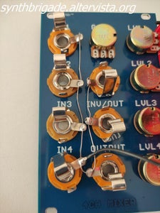

Step 3: Those Rare Cases Where the B-Side Is As Good As A-Side :)
Having a bunch of 5 pre-drilled panels for every module could not be cost effective (well: it actually is if you have more than one copy of the same module in your synthesizer), but what if we can adapt the same layout for two different modules at once?!
This is not always possible, but sometimes we could be lucky enought for this to be applicable. One of the projects I have developed for my synthesizer is a simple-but-active mixer. I will use it for both blending more than one AS3340 waveforms toghether and/or control more than one oscillator at once. When I layed the mixer's main PCB down and started to think at the panel, I immediately noticed that the VCO panel simmetry was such that it could be used for the mixer simply by rotating it on the other side!
You can see the panel B-side in the attached "rotating" gif animation :)
A dedicated Instructables on the mixer circuit and whole module can be found HERE (Instructables).

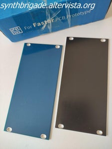

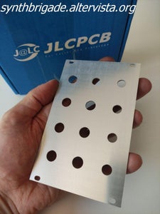

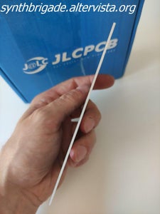

Step 4: Panel Board: a Step Further ...
In a previous Instructables we have seen that standard 1.6 mm thick, fiberglass panels/paceplates are an actual option for synth modules because they are easy to work on, cheap and sturdy enought for the application. But what if we still want them in aluminum?
Well, aluminum PCBs are actually another already available option!
Just to test them in my synthesizer I had a batch of 10, blank and pre-drilled and silkscreened panels manufactured by JLCPCB... and they look and work great!
Take a look at the pictures in this step: those are my VCO panels made of aluminum!
Then, if you have your panel layed down on a CAD software like EasyEDA, with all elements placed (holes, silkscreens, but also LEDs or other components you want in the front panel) having them manufactured could be an option to speed up the assembling process.
Just in case you want to speed your custom panel drawing: at THIS link (Github) you can download gerber source files for 3U tall, 4HP, 6HP, 8HP, 12HP and 16HP wide panels respecting eurorack dimensions.
Please notice that, at today, aluminum PCBs are limited to one layer, so it's not possible to have the B-side adapted/silkscreened for a second module like we did with VCO/Mixer fiberglass panels: the B-side is exposed aluminum here.
About bending: 1.6 mm aluminum panels are sturdy, at least up to 3U panel heights, and they have no tendency to bend.

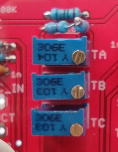

The board has three multi-turn trimmers for tuning: trimpot A (TA), trimpot B (TB) and trimpot C (TC).
TC has little to no effect on tuning, so forget it.

3) Turn TA fully counterclockwise and TB fully clockwise to maximise the oscillator frequency range.
