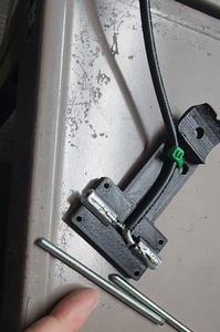

Attach the Coupling nuts to your threaded rod(makes it easier to hold), sand one side to remove the plating, then use the cutting wheel to make a notch lengthwise down all four coupling nuts (this is a notch to lay the wire into for stronger solder joints)
Cut your threaded rod into an 8cm and 23cm length ( these will most likely be trimmed further)
Step 3: Assembly
Once the prep work has been done We are ready to assemble
Trim your coax, Shielding will go to the counterpoise coupling nut, core will go to the driven element coupling nut
Go ahead and get the coax in position and zip tie it to help hold it in place
Lay your wires into the notches we cut into the coupling nuts and solder them in place
Be careful on the heat, it can melt into the print and it needs to some to really seat the nuts
Once both sides are soldered, put the second case half on and secure it
Now you can thread the 23cm long rod into the Driven element coupling nut and the 8cm long rod into the counterpoise coupling nut.
