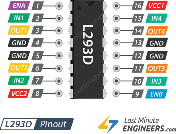

- 1 L293D Motor Driver Chip

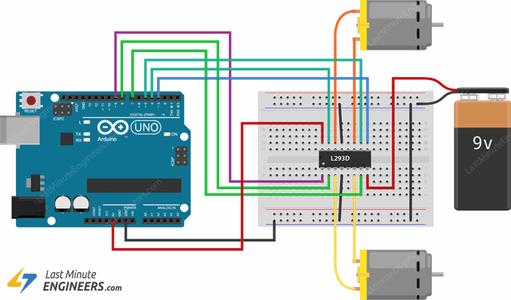

While the prints are running, you will begin to configure the electronics. Grab the small breadboard or the small protoboard, a handful of male to male wires, a soldering iron, solder, L293D motor driver board, HC-10 bluetooth module, the Arduino Uno, and the L shaped dc gearmotors. Once you have all of these materials, you will begin by placing or soldering components onto the breadboard/ protoboard. You will place the L293D chip in the middle as shown in the picture, and then you will plug in/ solder all the male to male wires in their designated location, as shown in the diagram, EXCEPT for the ports that the motors plug into. Once this is done, you will solder one end of the male to male wire to the positive and negative side of the gearmotors. Then, you will plug in/ solder the connections from the breadboard/protoboard to the Arduino Uno in the following order.
ENB ---> 6
IN4 ---> 4
IN3 ---> 5
ENA ---> 9
IN1 ---> 7
IN2 ---> 8
After this is complete, grab the 4 female to male wires, and stick the HC-10 pins to each of the female sides. Once this is done, you will want to stick the TXD of the HC-10 in the RXD on the Arduino, and the RXD of the HC-10 in the TXD of the Arduino. Plug the GND in the GND and the VCC into the 5V. Now we will move on to the program.

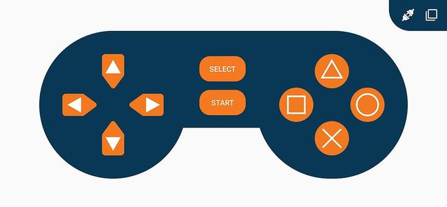

Step 5: Test and Enjoy!
Once this is done, you will want to open Dabble, and open the gamepad. Then you will want to connect to the HC-10 bluetooth module. You will click the button that looks like the plug in socket, and then you will want to find the HC-10 module and click and connect. Once you are connected, press the arrows, and your camera mount should be working!
