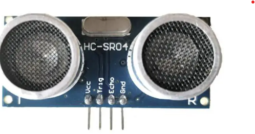

HC-SR04 Ultrasonic Sensors (x3) - For distance measurement.

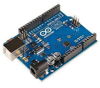

Arduino Uno R3 - For controlling the sensors and motor.

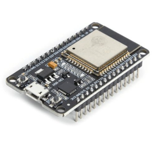

ESP32 WROOM - For wireless communication and data processing.

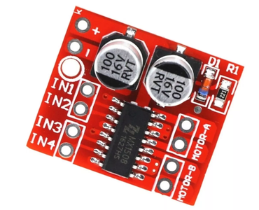

L298N Motor Driver - For driving the DC motor.

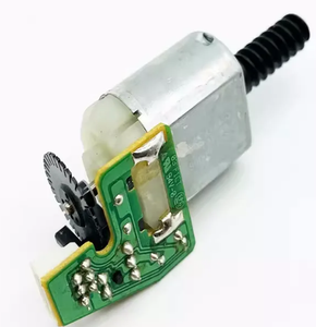

DC Motor - For rotating the sensor platform.

Step 1: Controlling a DC Motor With PID Control
I am using an Arduino to control the motor for accurate angle positioning. The Arduino allows me to precisely adjust the motor's rotation, ensuring that the platform moves by specific angles as needed for my 360-degree radar system. This precise control is essential for the system to function correctly, as it ensures that each ultrasonic sensor covers its designated segment accurately. The Arduino's ability to execute control algorithms and handle real-time adjustments makes it the ideal choice for this task.

Step 2: Synchronization of Three Ultrasonic Sensors
all three ultrasonic sensors share a common VCC and GND, and their trigger pins are activated simultaneously to initiate distance measurements. The interrupt pin is used to calculate the distance for each sensor. This setup ensures that all sensors are synchronized and their distance readings are accurately captured and processed.

Step 3: Connecting ESP32 and Arduino
The final step involves establishing communication between the Arduino and the ESP32. This is achieved by connecting pin 13 of the Arduino to pin 13 of the ESP32, allowing the two devices to relay data and coordinate their operations effectively.
