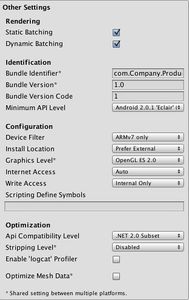

Step 6: Player Settings
Change Build Identifiers and Screen Orientation in the Player Settings.
"Bundle Identifier: The string used in your provisioning certificate from your Apple Developer Network account(This is shared between iOS and Android)"
"Default Orientation, Landscape Left: The device is in landscape mode, with the device held upright and the home button on the right side."
- Edit > Project Settings > Player
in the Inspector View:
- Android Settings > Other Settings > Identification > Bundle Identifier (replace com.Company.ProductName with your data, like com.MyCompany.MyProduct)
- Android Settings > Resolution and Presentation > Orientation > Default Orientation > Landscape Left
