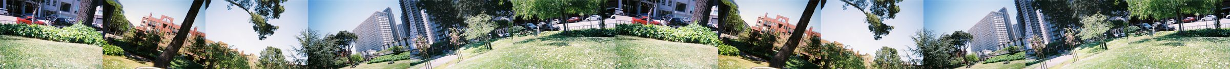

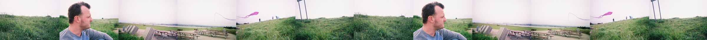

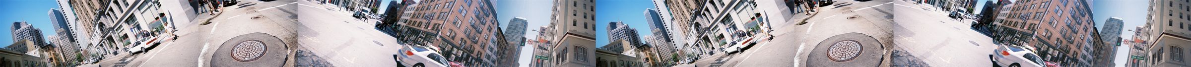

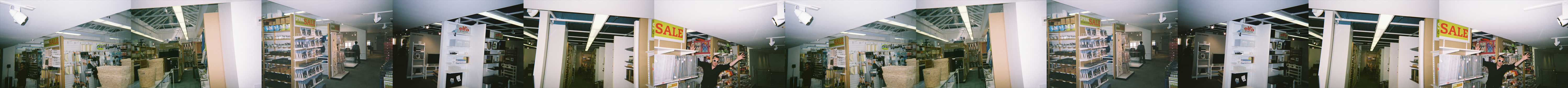

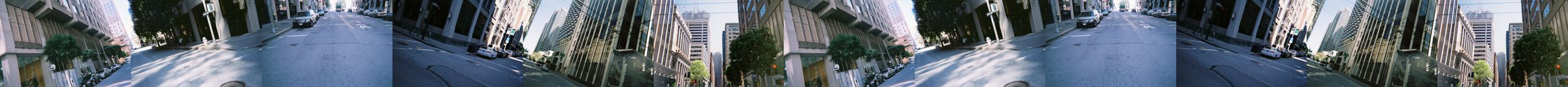

Here's a few of my shots compiled together digitally:
Of the 36 exposures for each camera in the array only about 10 "sets" came out with all six camera exposures in usable form. Of those 10 only the ones shown above were worth sharing, the remainder were either too dark, blown out, or incomprehensible to anyone who wasn't there when I took the shot.
