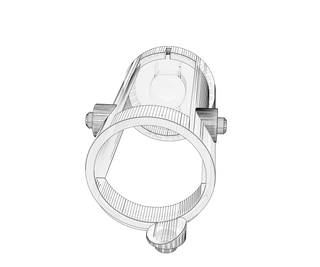

You'll notice a couple of discrepancies in the STL file and the parts in the photos.
First there is an extra file. This file is the post. I included it for two reasons, it was in the original design by Luginets and while not required for this project it was useful to print a few of these out and use them to fill the holes when painting in order to keep the paint out.
Second There are more parts printed than files. This is because I decided to slice the main body into three parts, print them separately and glue them together. I did this also for two reasons, the entire body was to tall for the print area of my M2 and by printing the parts separately I could mostly avoid the use of supports.
It is possible to print the main body in several separate parts from the same file simply by adjusting the start and stop print heights in your slicing software. (I used Simplify3D for this project.) I printed the main body in the following four parts.
From top to bottom the slices I used were:
- The very top and "eye". The part with the eye and just a couple layers of the top ring. Having this separate allowed me to print the main body without having to worry about this detail piece and also allowed me to easily paint this part a different color later in the process.
- The top "ring" and vertical supports. This was printed upside down. I simple flipped the model over and offset it through the bottom of the bed so that the very top part would not be printed. Then I set the stop print height so that it would end just at the point where the two supports meet the bottom cup. Since this meant that there were no overhangs except for the two nubs on either side, I didn't need to use many supports. I did have to turn off automatic supports and place supports manually under the nubs.
- The bottom "cup" this was printed right side up. However again I offset the bottom through the bed and set the end point so that it would stop just before it started to print the vertical supports. Again this eliminated the need for supports.
- The very bottom "vents". This was printed upside down since it was tapered and had with some detailing. This allowed me to avoid using supports, keeping the detail clean.
