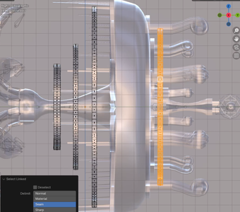

You can also separate some of the objects such as the tentacle/petal segments and floating rings by pressing control R to add edge loops and then deleting faces along an edge loop, then pressing 'L' to select attached, and finally separating from the original mesh by pressing 'P'. The separation is really helpful later when rigging the tentacles/petals since we'll be using a Blender addon to attach individual meshes to bones.

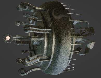

Step 4: Texturing and Shading
Create a material, then UV unwrap each object using cube projection and assign the material to them. Then open the material in the shader editor and apply this public domain texture I found on Pexels after cropping the image to make it tile. To add some interest, use these public domain parametrized noise textures. By plugging the output of one into the vector input of another, you can achieve an interesting, layered distortion effect that you can use for both the base color and the roughness.
Assign a second material to the sphere in the front of the ship and the engine area, then you can add a noise texture and change its output to emission. Animate the scale ratio of the noise node to simulate some kind of energy orb and a warp engine.

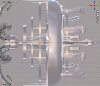

Step 5: Rigging

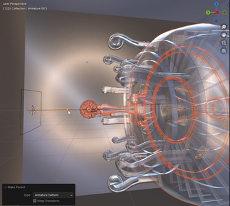

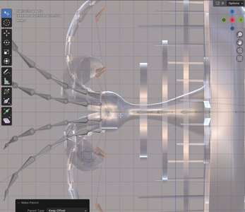

Create an armature and place the bone near the front of the ship. This will act as your root bone. Every other bone needs to be either connected to the root directly, or connected to chain that eventually connects to the root bone. This way, you can move the whole ship with one bone. Add a new bone to act as the subroot for the tentacles, and a new bone for the first segment of the tentacle. Note, up to this point, all of these should be parented FirstTentacleSegment>TentacleRoot>Root, and they should be disconnected. Now, start extruding the bone as many times as you have segments so that each segment has one. Make sure that the joint lines up with the bending apparatus for each segment. Also, make sure that the segments are individual objects with the part of the bending apparatus attached to it included in the object. You should be able to rotate one object with the pivot point at the joint and it should look right.
Now, once you have all the bones created, add one more bone that is disconnected from any of the others, and put it near the end of the chain. This will be the inverse kinematics control bone. This will make animating much easier later when we want to bring all the tentacles together without deformation. Add an inverse kinematics constraint while in pose mode to the last segment’s bone, and set the length to the number of segments in your model (mine is 7). Set the target to the armature, and the bone parameter to the kinematic control bone from earlier. Don’t worry about the pole target.
Now, when you grab the control bone and move it around, the whole tentacle should warp to reach that location. Next, go back into edit mode, select all the tentacle bones other than the tentacle root, but including the control bone, duplicate them, and type R, then the axis of your ship’s length (mine is Z when using the empty coordinate system), and type 45. Make sure the origin is set to world origin. It should snap the copy to the next tentacle. Then simply input shift-R 6 times and that will repeat the operation so you have all 8. Finally, download this free, opensource addon to assign each of the segments to the nearest bone. Before proceeding, it’s good to save your project in case it assigns to the wrong object so you can go back and tweak it if need be. After you’ve added the addon, go to object mode, and select all the segments and lastly the armature. Then go to object->parent->parentToNearestBone. This should attach each segment to the bone associated with it. For it to work, the origin of each object needs to be close to the bone you want it to attach to. The easiest way to do this is to right click on the object and press setOrigin>originToGeometry. The last things to rig are the rotating grill, moving rings, and the rotating pylons. I did this by just parenting these objects to the armature, adding new bones for them, and going into the data->Vertex Groups settings in the details pannel and adding a group with the exact name of the corresponding bone, then selecting all the geometry in edit mode and adding it to the vertex group. Whew! Now, you’re finally done rigging!

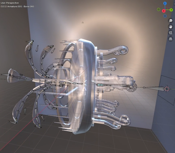

To get the ship to look like it jumps to warp-speed, create the final pose for it to jump, then add a null object at the back of the ship. Parent the ship’s armature to the null object and animate the scale of the null object so it stretches off into the distance and animate it’s location to shoot off a moment later. Again, you can change the curves and interpolation to achieve different effects. Mine was linearly timed.

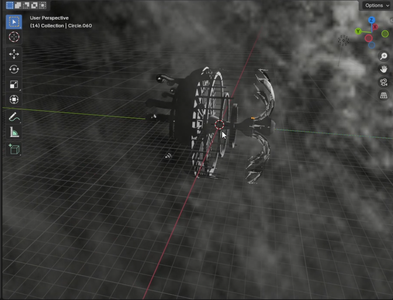

Step 7: The Nebula
Create the nebula by adding a cube to the scene and giving it a noisy volumetric shader. You can change the cube’s viewport settings so it doesn’t obscure your scene by going to object settings->viewportDisplay->display as and set it to bounds. Next, map a new material to the box’s material->volume setting. Give it a neutral color so you can color it later using the lights. Use these public domain parametrized noise textures and use a color ramp to add contrast resulting in a crisper nebula. By chaining the noise textures through the vector input, you can get a very distorted, nebula. Finally, use an “add” node to give it a little bit of fog to add depth to the scene.

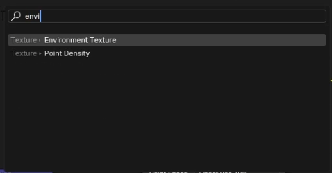

For the background stars, use the 16k version of this public domain HDR 360 image of space from NASA. Switch to the world shader in the top left of the shader editor. Then map it to the world output surface using the Environment Texture node piped through a "background" node. You can control the rotation of the environment using texture coordinate and mapping nodes piped into the environment texture vector. The X, Y, Z rotation values in the mapping node changes where the stars are in the sky. To control the intensity, change the strength in the background node.

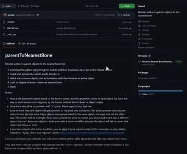

Parent area lights to the ship rig's root bone using the parent to modifier. These will work for the power source in front of the ship and the engines in the back. Place two point lights in the nebula to give some directional light to the ship and to light up the nebula itself. Add a rim light behind and slightly to the side to produce a strong silhouette of your model. Render the scene in EEVEE, Blender's real-time rendering pipeline, to get a good idea of how the lighting will look without waiting ages for renders. Change your viewport render settings to have less sampling and more denoising in Cycles if you want to quickly see it in the same rendering engine used in the end.
