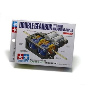

The base of the project was the Tamiya 70168 Double Gearbox and tires, bought for another project.

(1) Tamiya 70168 double gearbox.

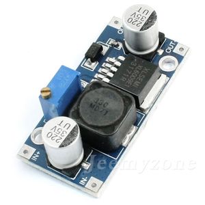

(1) 5-35V DC-DC Step UP Adapter Booster.

Step 10: The Circuit - DC Booster
A step up booster is a circuit made to raise an input DC voltage, in this case, the nRover/Arduino can be powered by four rechargeable batteries of 1.2V each, to 7V or more.
