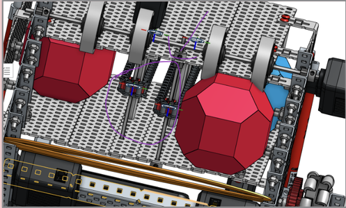

The most important part of this process comes down to solving the variety of challenges. One major challenge that I faced was how my intake rollers were blocking a part of my storage system making it inaccessible for blocks. This major problem brought my total blocks that I could store in half. I started brainstorming to how I could solve this problem. I decided to come up with several different solutions, bring the pro and cons of those solutions, and decide on the best one. My options were as listed below:
  1. Somehow move my pneumatic system so that I could align the storage system to which its one side wouldn't be as inaccessible.
  2. Pros: Would solve my problem without having me change my storage system at all.
  3. Cons: The C-Channels holding the pneumatic system up would block the system entirely forcing me to do a full redo of it.
  4. Move my chain in the middle of the system that helped push the blocks out a bit back allowing for enough space in the front to allow the blocks in.
  5. Pros: Would solve my problem without forcing me to change any of my pneumatics and intake rollers.
  6. Cons: Might allow blocks to slip out of the system if enough gap is created from the changes.
My final decision that would have minimal changes was option 2 with it only requiring me to change the position of the chain. The pictures above show the difference between the two chains now with the left chain being pushed back significantly enough to keep it accessible for blocks.
