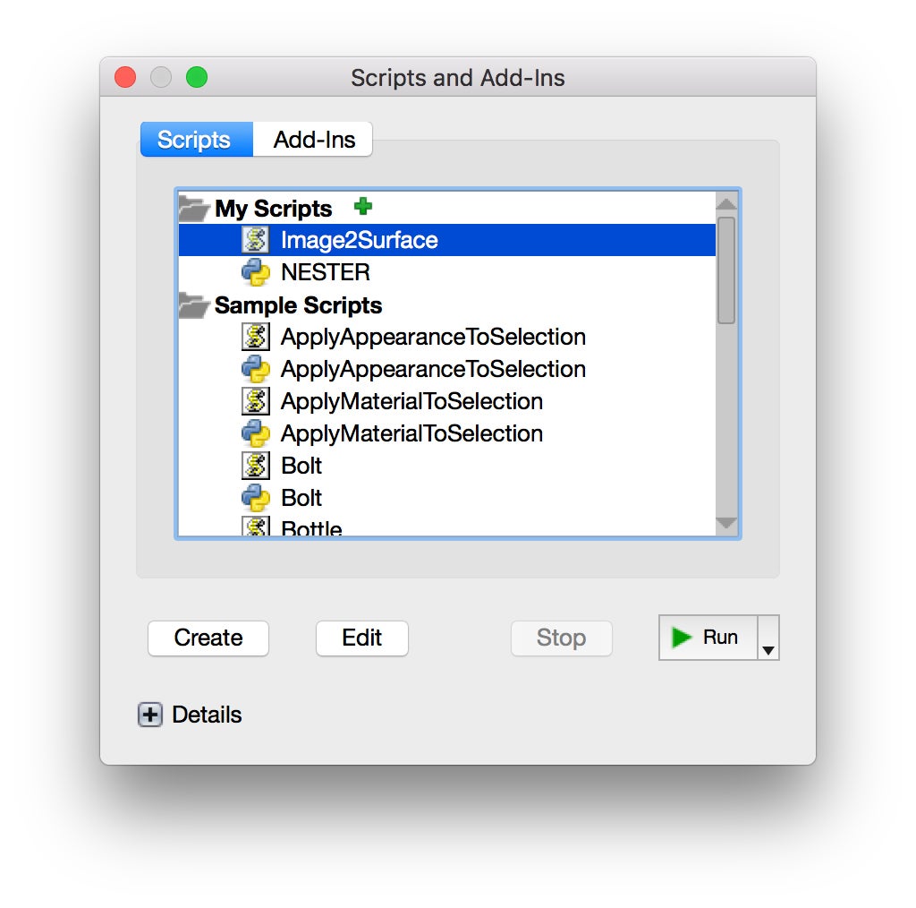

INSTALL THE SCRIPTFirst, download the Zip file attached belo and unzip it in a location of your choice. I would advise keeping it some place other than the Downloads folder, or any other folder that is regularly cleaned out.
To load the script in Fusion, follow these steps:
- Start Fusion 360 and then select the ADD-INS > Scripts and Add-Ins... menu item.
- The Scripts and Add-Ins dialog will appear and display the My Scripts and Sample Scripts folders.
- Select one of the My Scripts folders, then click on the + icon near the top of the dialog.
- Locate the Image2Surface.js file in the folder you copied, select it, and click Open. The script should now be installed and ready to be run.
Scripts and Add-Ins Menu
STEP 6: Use the Image 2 Surface Script
After opening Fusion, I save the untitled file with a new name.
With my file saved, and the Workspace set to MODEL, I go to ADD-INS > Scripts and Add-Ins... I select Image2Surface from the list and click Run.

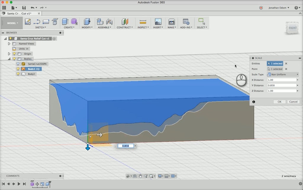

Looking at the surface from the side, rotate it 90º so that the top of the surface is facing up.
The size of the surface is based completely on the original bitmap image, so now you'll need to scale it to fit the actual size of the piece you want to cut out. To do this, make sure the body is selected in the BROWSER and go to MODIFY > Scale in the menu. Click Point and select the model origin.
NOTE: You may need to turn on Origin in the browser in order to see it.
Looking at the surface from the Top view, change the Scale Factor so that the surface fits within the size of the piece you want to cut out. I'm going to use a 3" X 3" piece of wood, so I'm looking for a scale factor that will give me a SURFACE that's just slightly BIGGER than 3" X 3". I can see how big it is on the layout grid.

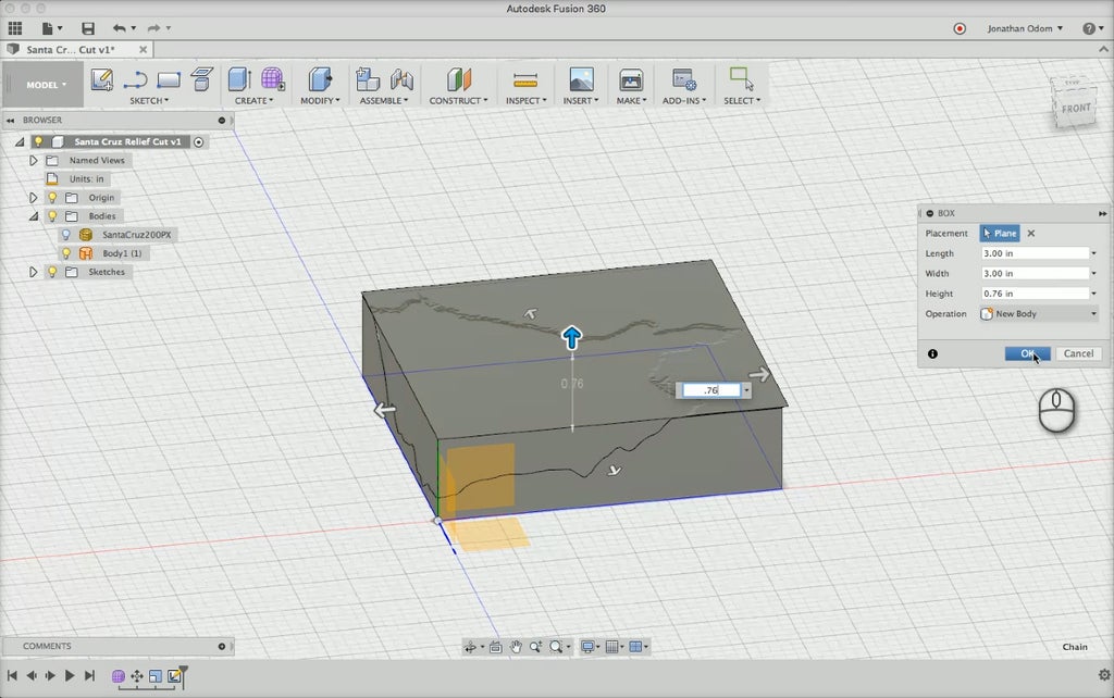

Now that the surface is in place, create a box to represent the material to be cut out. I'm using a 3" X 3" X .76" square, so I go to CREATE > Box and click the model origin as my starting point. The box command asks for a width, a depth, and a height, which you can enter by typing a number and pressing Tab.
I can see that the surface to be cut is actually taller than the material to be cut, so not I need to scale the surface down in the Y dimension. I use the Scale tool again, and change Scale Type to Non Uniform. This option will let you scale in any dimension independently. For Y Distance, Choose a number that gives you some breathing room for the surface to fit within the block.
To move the surface closer to the top of the block, Right - Click > Move the surface up in the Y direction so that it's just below the top of the block.

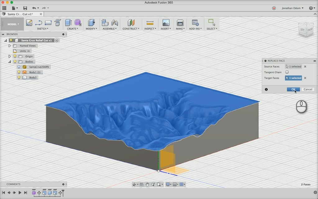

With both the block and the surface in place, go to MODIFY > Replace Face. Like every other tool in Fusion, it tells you what it needs to work. First, select the Source Face, which in this case is the top surface of the block. Then, click Select under Target Faces and select the surface you just converted from the original mesh. Click Okay, then turn off the original body in the BROWSER and you'll see the finished surface that you'll be making on the CNC.
