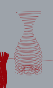

Step 1: The Tokkuri
For the main body of the tokkuri, I used 4 CoilCAM components together to create its profile shape.
The Linear, Sinusoidal, and Exponential components are all in additive mode, so I think the order they're applied should be interchangeable.
I want to keep the bottom of the tokkuri straight-ish, so I used 2 Sinusoidal components with different parameters together to smooth as well as exaggerate different parts of the profile curve. The Linear component narrows the top of the tokkuri, including the neck of the bottle. The Exponential component was used to make the top of the bottle more flared.
I didn't add any surface texture to the tokkuri because I wanted to keep it relatively smooth.

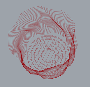

Step 2: The Cups
For the cups, I want to create a flower-like shape, and add some interesting textures.
The Square component adds some protrusion to the radius. The Linear and Sinusoidal components shapes the profile of the cup. The Staircase component rotates and "twists" the shape of the cup.
Next, I moved the cup's position to partially overlap the tokkuri. Using the Difference component, I removed the intersecting volume from the cup, creating a concave surface.
I made a copy of the originally circular cup, and differenced it with the first cup. It resulted in a more textured concave surface.
