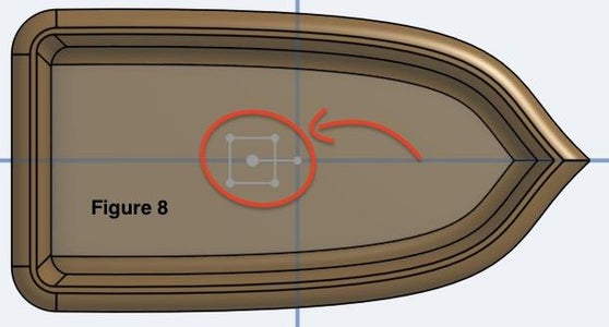

  1. Start a new sketch on the floor of the hull
  2. You should dimension this with your desired dimensions of the mast
  3. I used .25" in both directions, and I wouldn't make it smaller, as you will need room for the next steps
  4. Ensure this sketch is centered on the hall side to side
  5. See my example in Figure 8

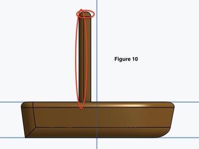

  11. Add fillets to your mast
  12. You can dimension these fillets to whatever looks appropriate, but remember to leave material for the next step
  13. Do not fillet the face facing the bow of the boat
  14. You can find my example in Figure 10
  15. Accept the fillets

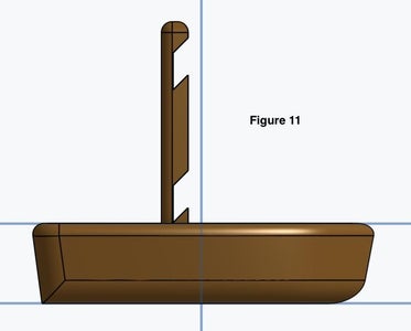

  16. Create two slits for which your sail will fit into
  17. To do this create a sketch on the front plane
  18. Draw slots that look like those in figure 11 and ensure the angles are no greater than 45°
  19. If they are over 45°, you may have issues printing them with your printer
  20. Extrude the sketch using a midplane remove extrude

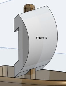

In this section, we will create the sail of the toy boat
  1. Create a new sketch on the plane
  2. Click to use the geometry from the slots and then draw an arc between the top and bottom of the far ends of each slot
  3. You can see this in figure 12
  4. Extrude the sail to what looks appropriate
  5. See Figure 13

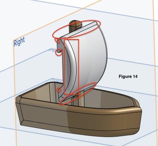

  6. If you're working in a CAD software that allows it, select to make this extrude a new part
  7. Through it all edges as shown in the diagram of Figure 14

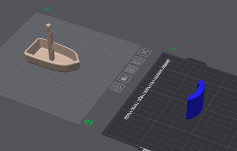

  1. Click to export your parts as an STL
  2. Arrange them in your given slicer of choice as shown in the image
  3. I chose to split them into two plates in order to use different colored filaments without waste
  4. Even if you're slicer prompts, you shouldn't need any support if you follow the instructions
  5. Hit print
