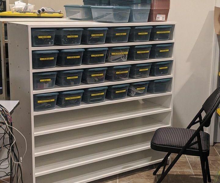

So my first thought was just a storage bin. If you follow my other instructables, bins saved my life.
