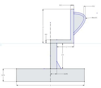

Step 1: Create the Sketch
Create the sketch of the trophy on the front plane. The base of the trophy is fully drawn while only one half of the other part of the trophy is needed.
Step 2: Extrude the Base
Extrude the base 3 inches symmetrically.
Step 3: Revolve the Bowl and Stem of the Trophy
Revolve the bowl and the stem around the construction line. Do not revolve the handle.
Step 4: Extrude the Handle
Extrude the handle 0.3 inches symmetrically.
Step 5: Mirror the Handle
Mirror the extruded handle part across the right plane.
Step 6: Fillet the Bowl
Fillet the bottom of the bowl. The radius should be 0.5 inches
Step 7: Chamfer the Bowl
Add a chamfer to the top of the bowl. The inside and the outside edges should both be selected. Chamfer it to a distance of 0.1 inches

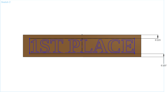

Step 8: Create the Sketch of the Text
Create a new sketch on the front of the base. The text is in bold and the font is Tinos. A rectangle is created with the top part aligned with the top of the text while the bottom of the rectangle is 0.107 inches away from the bottom of the base.
Step 9: Extrude the Rectangle
Extrude the rectangle surrounding the text 0.02 inches. Be sure to include the hole in the "P" and the "A".
Step 10: Extrude the Text
Extrude the text 0.03 inches.
