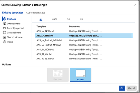

  6. Right-click on 'sketch one', which can be found on the left side, and select Create Drawing of sketch one
  7. Select the ANSI_A_MM template provided and select no views at the bottom, and click "OK" (image 2)
  8. Insert the pentagon, make sure to set it 1:1 ratio (image 3)
  9. Export this drawing as a DWG file
  10. Use a DWG to PDF converter to convert the drawing to PDF
  11. Print the PDF with a 100% scale

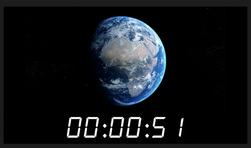

Step 5: Creating the 3D Hologram Video
To create the clock and spinning globe:
  1. Download a digital 12 hour clock on YouTube
  2. https://youtu.be/VSBmKf2S5qI is a good example
  3. If you're using this video, ensure you hide the borders by cropping the video, this can be done in the Premiere Pro "Effect Controls" window with "Crop Top/Bottom/Right/Left"
  4. Download a spinning globe video on YouTube, ensure it loops
  5. https://youtu.be/aiQdLP2mBJE is a good example

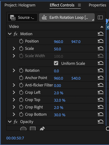

  6. Using Adobe Premiere Pro or any alternative, insert the two videos by clicking on the "Project" window, then drag and drop the two videos in (image 1). Put the two videos together. First, resize it so that the globe is decently big, with the clock being smaller.
  7. Ensure you lock the aspect ratio, in Premiere Pro, you need to hold shift while resizing
  8. To make sure the videos are aligned to the y-axis, hold shift while transforming it
  9. Position the clock so that it is underneath the spinning globe. (image 2)
  10. Copy and paste the spinning globe looped video until it hits the 12 hour mark (image 3)
  11. Export the video by going to File > Export > Media
  12. Ensure you disable audio
Now we need to make it into a 3D hologram shape to ensure the light refracts correctly
  1. Open another project in Premiere Pro or any alternative, then insert the exported video
  2. Get a sample 3D hologram video from YouTube to get the correct position and sizing
  3. To do this, we will play the video in full-screen and take a screenshot
  4. Insert the screenshot into Premiere Pro by saving the screenshot, and then by dragging and dropping it into the "Project" window
  5. Decrease the opacity of the screenshot to 50% or to a point where you can see the exported video and screenshot at the same time
  6. Resize and position the globe and time so that it matches all four sides of the screenshot
  7. To rotate videos in Premiere Pro, you can go to the "Edit" window, and it will be under "Rotation" (image 4)
  8. The left video should be rotated 90°, the bottom should be 180°, and the right should be 270°
  9. Now we need to flip each video so that it appears correctly when it refracts, to do this, we will flip each video
  10. To flip the video, we will go to the "Effects" window, not to be confused with the "Effect Controls" window, open the "Video Effects" folder, "Transform" folder, and then finally "Vertical Flip"
  11. Your final video should look like image 5
