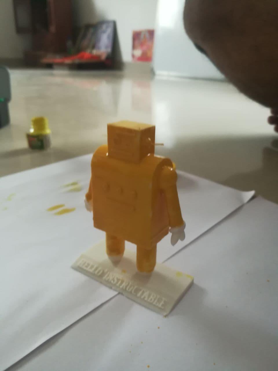

Step 4: Painting 3D Printed Model
  1. Use Acrylic Color for Painting model in yellow.
  2. Use Sketch pen color for more detailing.
Step 5: Showcasing Model
  1. After Painting the model check out my model and Instructable LOGO.
  2. You can place it on the desktop and as a showcase.
  3. Hope you Like my Project.
  4. If you need more Help Check out my Step by step Making video.
