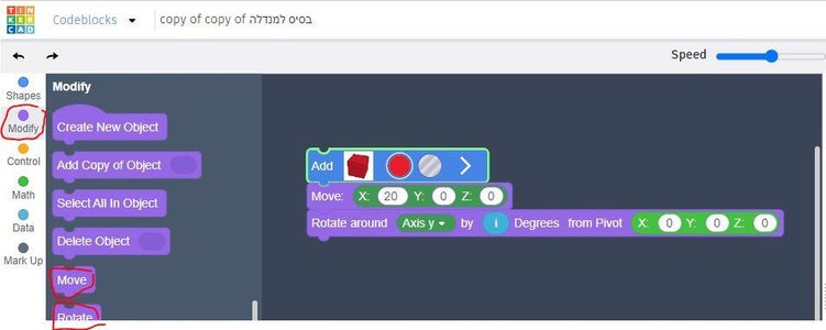

We need to choose the first shape of the blocks for the first layers. Choose from the given 3D blocks shapes and drag it to the working area and then, we need to move this block to the appropriate place on the work plane. For that, click the Modify option on the upper left side and drag the Move block to the working area and connect it under the shape block.
Step 3: ROTATE THE SHAPE IN a CIRCULAR MANNER

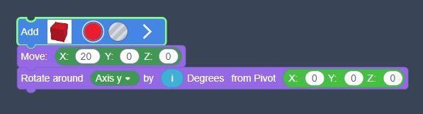

After that, rotate the shape around the Y-axis by some degrees, in between of 40 degrees to 360 degrees. For that one, we need to drag the Rotate block and connect it under the Move block
Step 4: Duplicate the First Shape in a Circular Manner
To duplicate the shape in a circular way around the Y axis, at equal distances from each other, click on the control area, select the "count with" loop and enter the size of "i"- the spacing between the shapes up to 360 degrees: "count with "i from 1 to 360 by 40" . In this case, the space between the shapes in the first circle of the mandala will be 40 degrees. In this first circle,the number of shapes will be 360 divided by 40 degrees. That means the amount of shapes will be 9 shapes arranged in a circle.

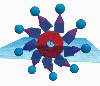

To add another larger circle to the mandala, we will duplicate the loop block code that we created in the previous section and change the shape type to another shape, increase the radius of rotation around the Y axis to 40 instead of 20 and connect the new loop code blocks with the previous loop.

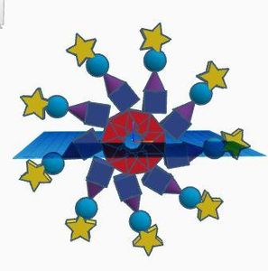

To add another larger circle to the mandala, we will duplicate the last loop block code again and again increase the radius of rotation around the Y axis from 40 to 60 and connect to the previous loop. Each time we will increase the radius of the circle by 20 mm.
