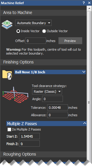

For the 3D toolpath, we will machine within a vector boundary. When generating a Machine Relief toolpath within a specific area, it is good practice to offset the vector outwards by a little more than the radius of the tool you will use to cut it. The reason being, that during a Machine Relief toolpath, the center of the tool stops on the vector. Since the vector is right up against the relief, the tool cannot drop down to reach the bottom edge of the relief. If we offset the machining vector by the radius of the tool, there will be enough room for the tool to reach down to the base of the relief. However in the Machine Relief we can have ArtCAM create a machining vector for us containing the correct offset (radius of tool) for the required cutting tool. The Automatic Boundary option will automate this whole process.
Machining the Lizard

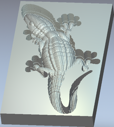

1 Open the Machine Relief toolpath strategy ![]()
- Select the Automatic Boundary function
- Offset = 0
- Finish Tool = 3mm ball nose (1/8 Inch ball nose)

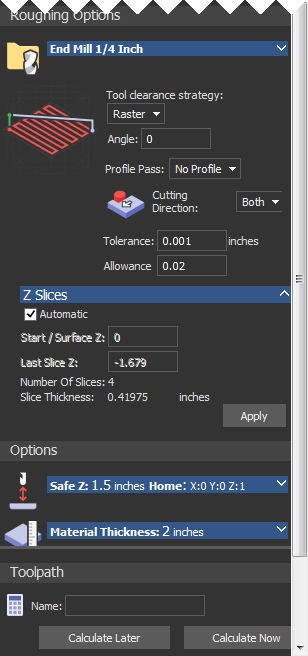

- Rough Tool = 6mm end mill (1/4 Inch end mill)
- Stepdown= 13mm (0.5”)

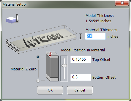

2 … continue Machine Relief Toolpath:
- Material
- Thickness = 50mm (2”)
- Material Z Zero= top
- Bottom Offset = 8mm (0.3”)
We are leaving 0.3” (8 mm) of stock material underneath the lizard, this will help strengthen the finished part.

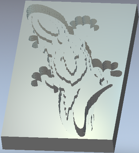

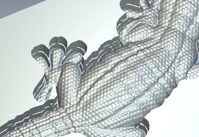

3 3D View
4 Click the Calculate Now button
5 Close
6 Simulate Toolpaths![]()
