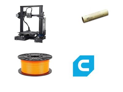

model rocket engine
filament
3D printer
slicer
