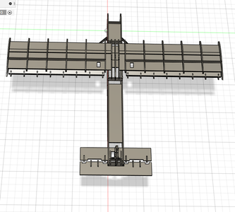

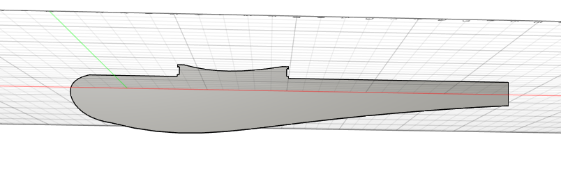

Step 1: Create the Basic Shape
I began by looking at airplanes for inspiration and creating this simple body design that fixes the wings to the top.

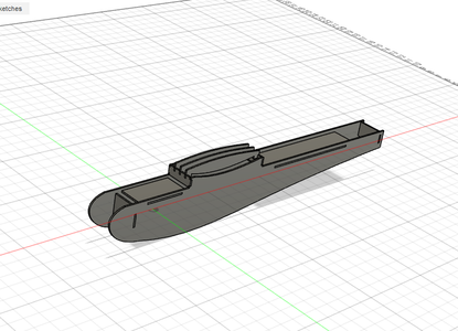

Step 2: Finish Body
From there I finished making the body and added lots of supports to keep it together. Make sure to include tabs that allow the parts to fit together.

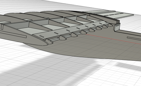

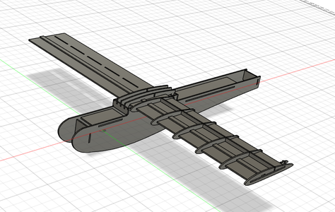

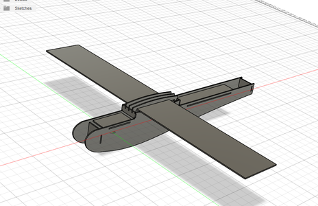

Step 3: Create the Wings
Now its time to move on to the wings. You have to make sure there is a large area for the wing to connect to the body and so that it doesn't sag down when assembled. Add ribs to the top of the body to slot the wings into for lots of support.
Step 4: Add Ribs and Supports to Wings
We need to give the wings some type of shape if we want it to be able to fly. Create an airfoil shape and make ribs that will slide on to the wing. These ribs will give support and shape to whatever canvas we wrap around the wings. Add multiple supports to keep these ribs spaced correctly and secured to the wing.

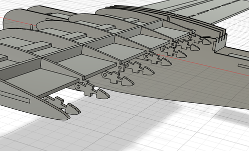

Step 5: Design the Ailerons
This part can be difficult because once again we need to create an aerodynamic 3d shape out of 2d pieces. I made an interesting connector that connects a top and bottom plate together while keeping somewhat of a 3d aerodynamic shape. These ribs then connect to an axle that goes through the ribs we made in step 4.

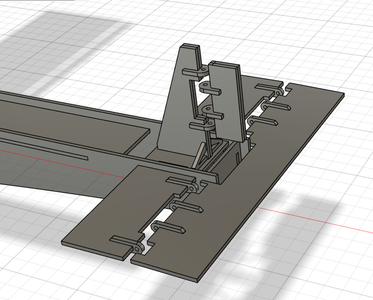

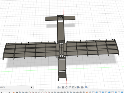

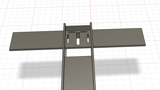

Step 6: Create the Horizontal Stabilizer
After you finish with the wings and ailerons, make sure to copy one side of the wing over to the other, its time to begin the tail assembly. Start by making a slot in the back of the body and adding a basic horizontal stabilizer. Add slots in the stabilizer to accommodate the vertical stabilizer as well as some supports.

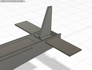

Step 7: Add a Vertical Stabilizer
Now just add a vertical stabilizer that slots into the plate for the horizontal stabilizer. Add some supports as well.

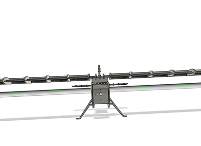

Step 9: Finishing Up
The last couple of steps include adding holes for the servo motors to go. These will control the ailerons, rudder, and elevator. Also make dure to add some landing gear and a mount for the motor in the front.
