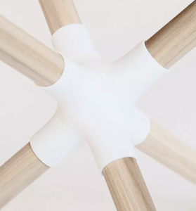

We were asked to design and 3D print a joint that fits 3 to 4 wooden rods/profile. Thus, I got the idea to design this vase-liked joint structure.
Step 1: Gain Inspiration and Determine Which One to Imitate
The first and the most important step for me was to gain some inspiration and try to figure out what most of these joints look like. Those images above reflect how these joints mainly looks like and how they functions to connect sticks or holders.
Finally, I determined to model the shape like the branches, with one main branch and four minor branches towards four directions.
