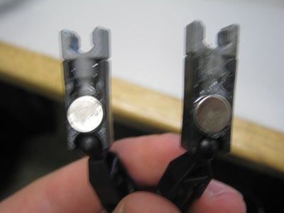

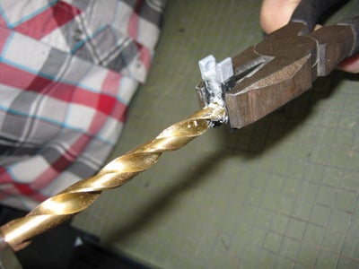

  1. After the glue has dried then drill a halfway into the center of each foot using a drill and a 5/16" drillbit
  2. Now use a toothpick to put a bit of epoxy glue in each hole
  3. Now put the 1 rare magnet in each hole and press them in so their secure
  4. after they have dried then re attach the feet to the legs of your K'nex body

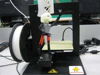

Step 7: K'nex Body Animation
Know that your custom made figurine is ready, you can animate it.
Here is my animation of my skull guy:
Step 8: Skull Print Timelapse
Here is a timelapse of the 3d printer printing the skull head:
