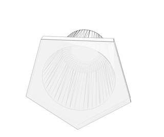

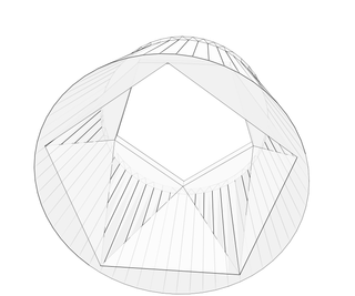

1. So basically, just download both STL files (mold A is the shell and mold B is the cavity part) and 3D print with a 3d printer. It should take about 6 hours to print both halves on a conventional FDM (fused deposition modeling) printer. I used a RepRap Prusa i3.
