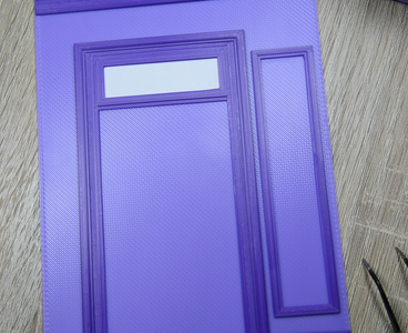

1) Print the box in light purple and the frame in black (or any colour and paint it black afterwards).
2) Print the bottom layers of wall panels in light purple and then switch the filament to dark purple. You can do that by modifying g-code in Cura slicer.
  • Once your wall panel is imported to Cura, select the layer heights, temperatures, infill and all that. Then switch to preview where you can see the layers. Count how many layers need to be printed in light and at what point you need to switch to dark filament.
  • Then, in the menu bar go to Extentions>> Post Processing>> Modify G-Code.
  • Click Add a script, then select Pause at height.
  • Change Pause at to Layer Number.
  • In Pause Layer type the number of layers you need the light purple to print.

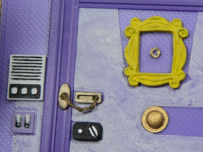

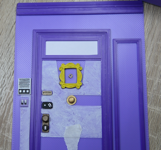

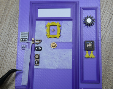

All the details for the door and the walls are printed separately and painted with acrylic and metallic paints.

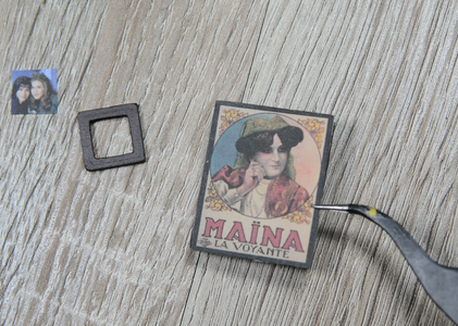

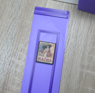

I printed Monica and Rachel picture, MAINA LA VOYANTE and floor boards on thick printing paper.
The only thing I couldn't 3D print was the chain for the lock and tiny tassles. I made the chain by grouping together a few strands of thread and tying it in knots every few mm. I painted it with metallic paint.

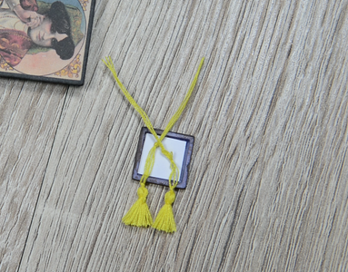

I made tiny tassles with yellow thread.
I made the peep hole by slicing a small piece off my PTFE tube and painting it gold.
The light switch has tiny white plastic buttons I made out of white milk bottle.
You have to glue the painting to the canvas and Monica's picture to the frame as well as two tassels.

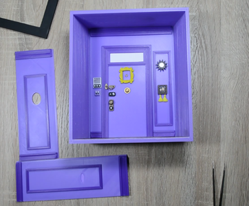

Step 3:

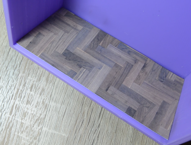

Print a good quality wooden floor and cut it to size using the sheet guide (thin, black slices you can see in my Tinkercad file). Glue them to the bottom part of the box.

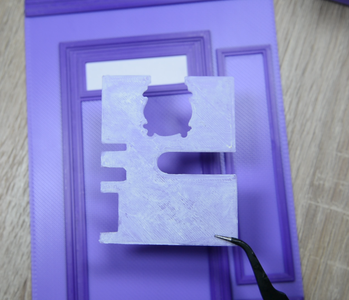

Step 4:
Print the rest of the guide sheets and place them over the door and walls. Apply a tiny amount of glue in the cut out areas and place your small details, make sure glue doesn't leak towards the guard lines. Once glue is set, you can pull the guide sheets away.
Step 5:
Assemble the box by gluing all the wall panels to the inside.
Glue the black frame to the box.
