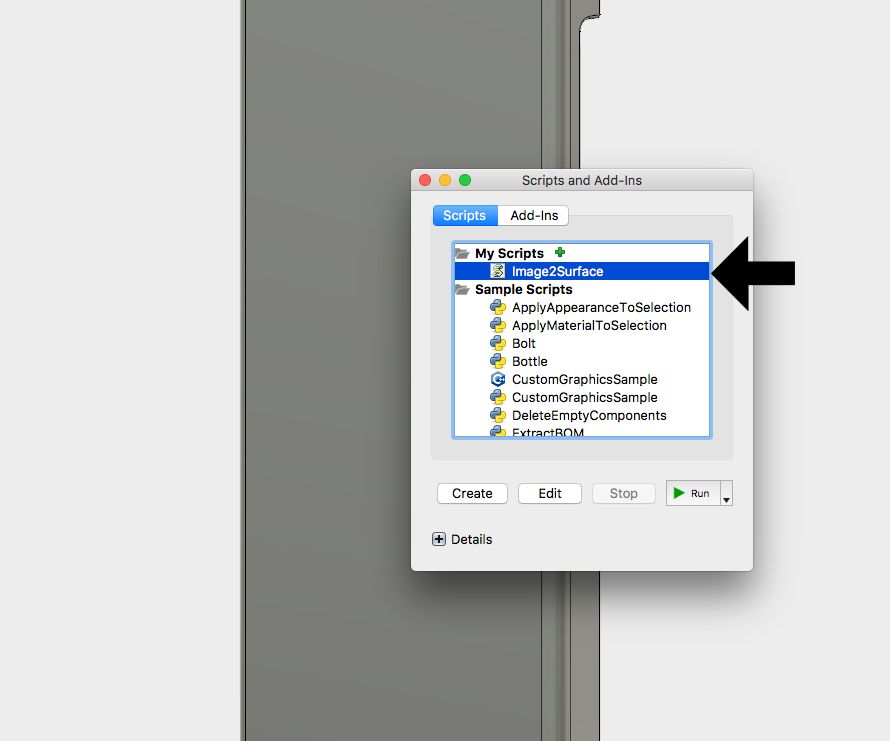

- Start Fusion 360 and then select the ADD-INS > Scripts and Add-Ins... menu item.
- The Scripts and Add-Ins dialog will appear and display the My Scripts and Sample Scripts folders.
- Select one of the My Scripts folders, then click on the + icon near the top of the dialog.
- Locate the Image2Surface.js file in the folder you copied, select it, and click Open. The script should now be installed and ready to be run.

With my file saved, and the Workspace set to MODEL, I go to ADD-INS > Scripts and Add-Ins... I select Image2Surface from the list and click Run.

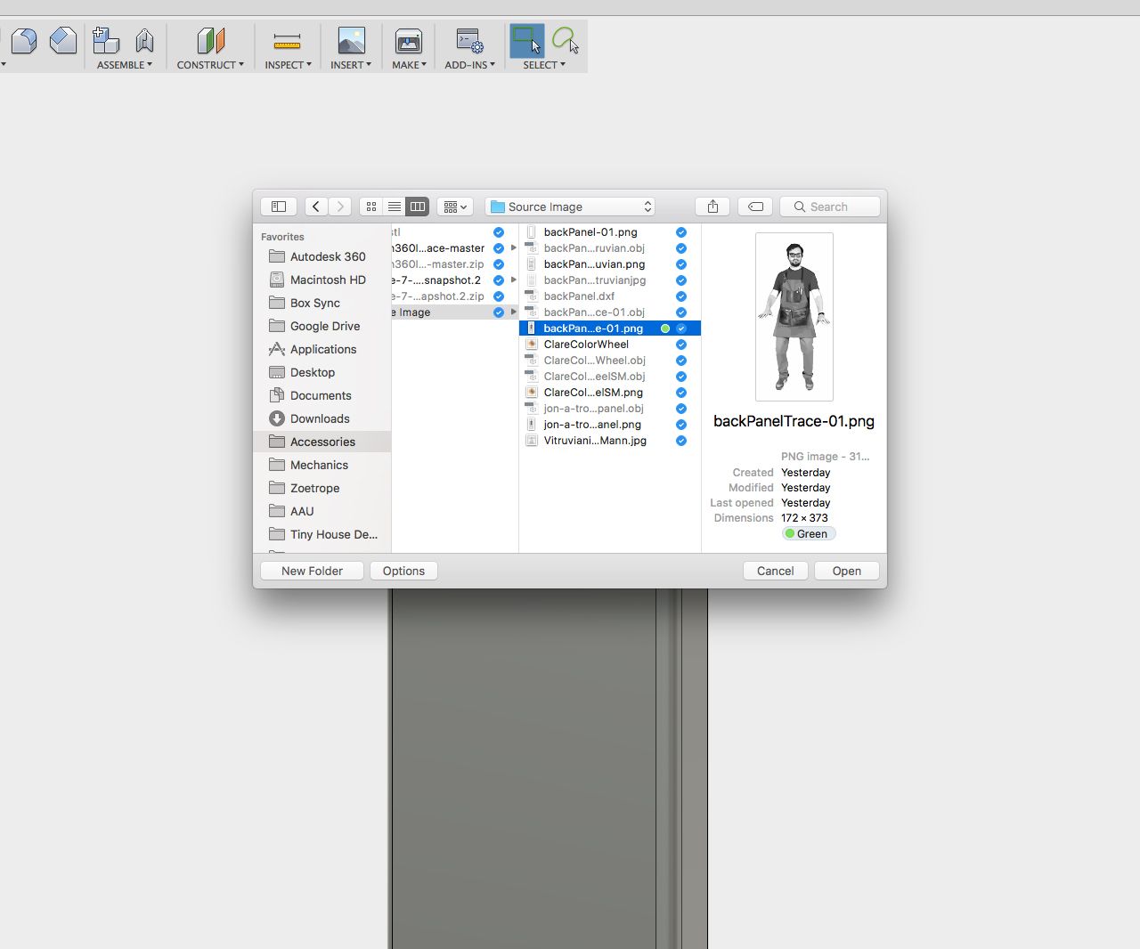

CHOOSE A BITMAP IMAGE
The script opens a window where you can choose a bitmap image. I'm using the self-portrait shown above.
IMPORTANT: the image should be a small size. The higher the resolution, the more points on the mesh, which means slower performance or crashing. The image I'm using is less than 300 X 300 PX and seems to work fine. Notice also that the image is blurred- this makes for a smoother mesh.

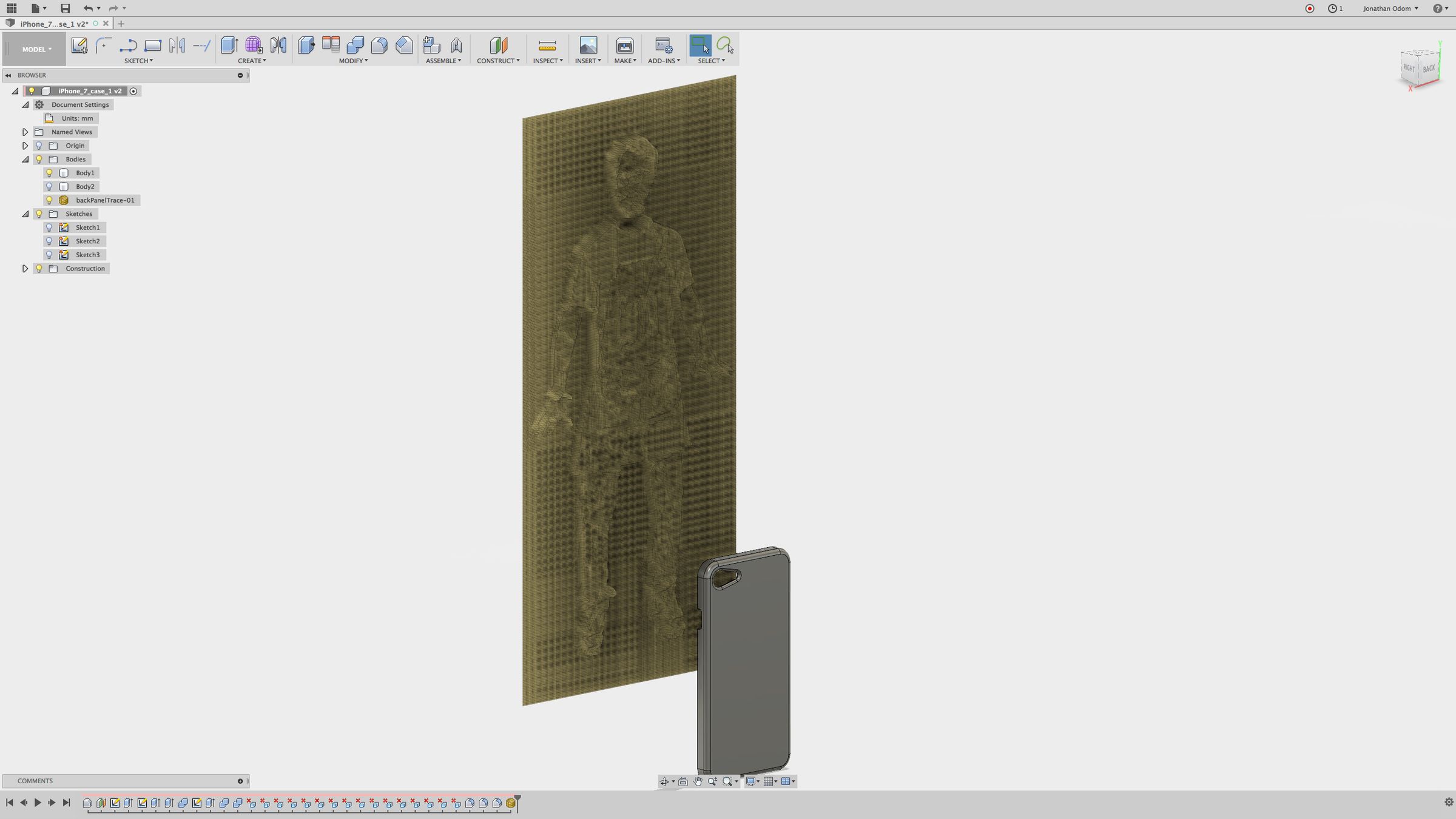

If all goes well, you'll have a mesh surface based on the image you chose.

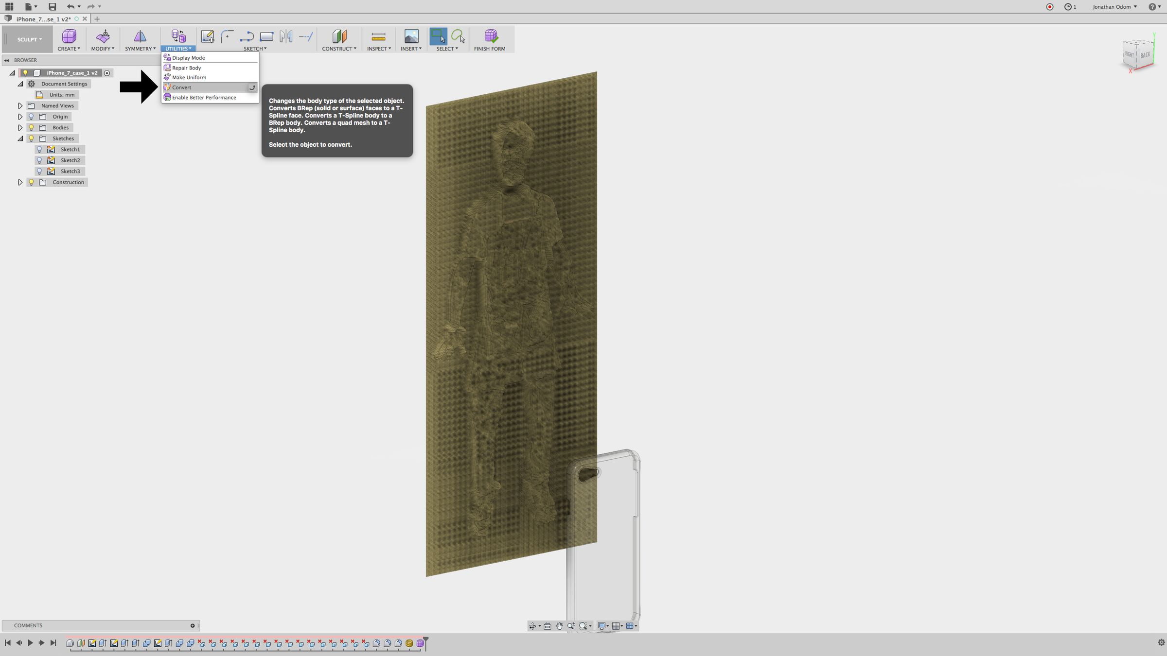

Step 6: Convert to T-Spline
The surface the script creates is a Polygon Mesh surface. This type of surface is made up of facets with edges and points. If you zoom in, you'll see that there are no curved surfaces.
This type of geometry can't be used to make g-code toolpaths, so we'll need to convert it to T-Spline geometry. A t-spline is a type of NURBS geometry that works with control points that affect a flexible surface.

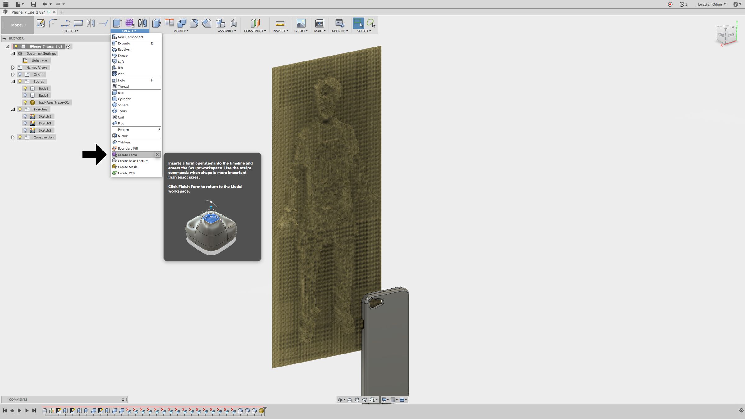

You're going to need T-Spline geometry to create your 3D surface, so click the CREATE > Create Form tool from the menu. This tool takes you into the SCULPT workspace.

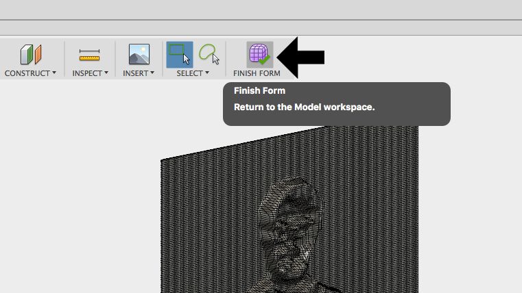

Next, click UTILITES > Convert and select Mesh Body in the Selection Filter. Now click the mesh surface that the script created and click OK. Now it's time to be patient and let the program do its work converting the surface to a T-Spline body- it might take a couple of minutes.
When the conversion is done, click on Finish Form on the upper right of the toolbar to go back to the Model workspace.

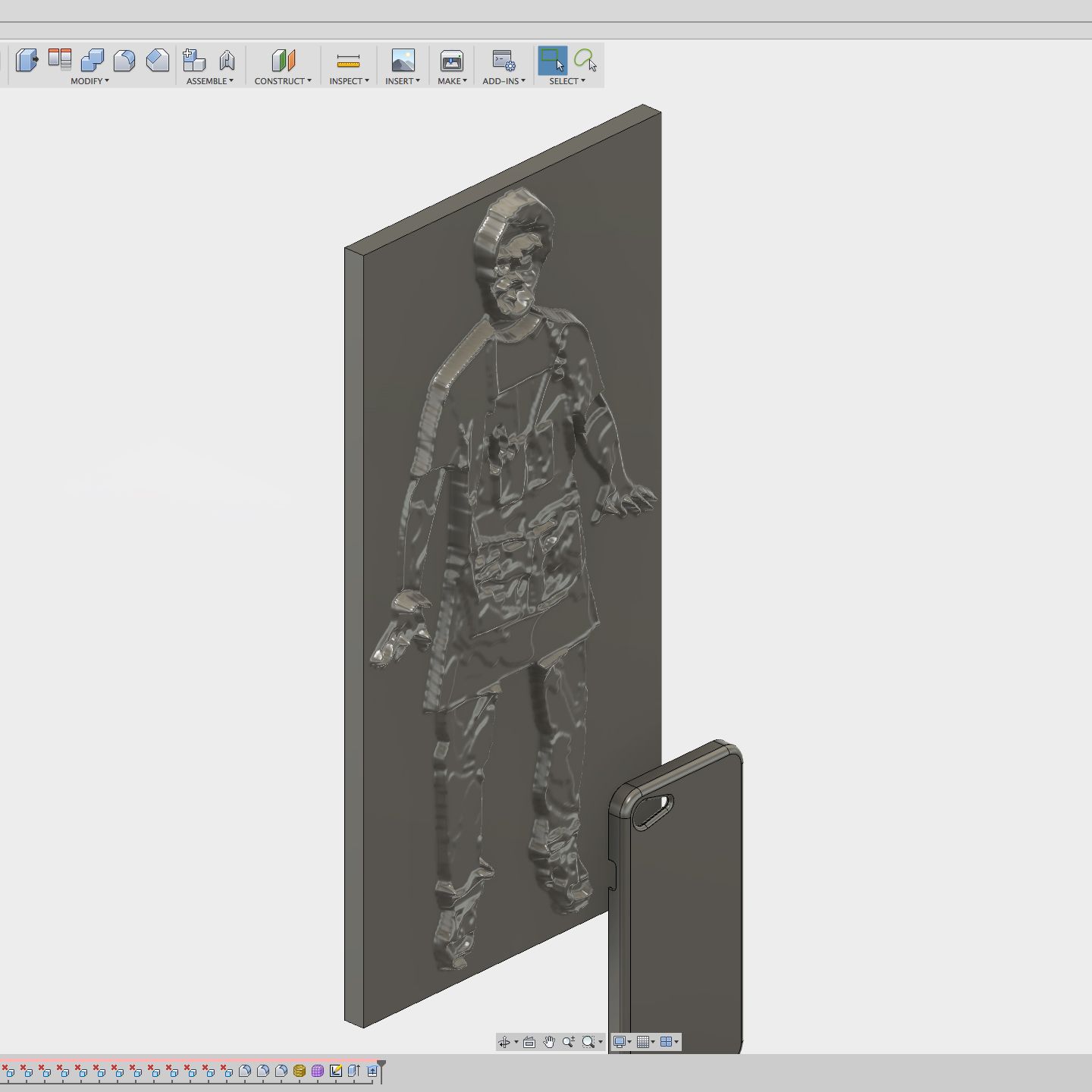

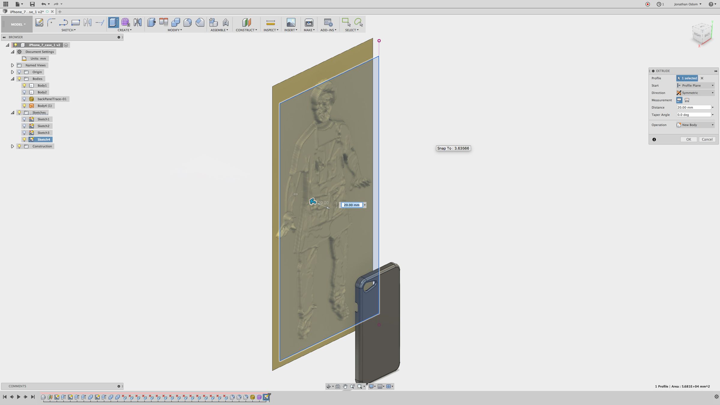

A t-spline surface won't be of much use on its own, so now you'll need to make a solid object with it. Make a Sketch, draw a rectangle that's slightly bigger than the boundary of the 3D surface of the picture, then CREATE > Extrude it so it's deeper than the overall depth of the 3D surface.
The Operation here should be New Body.

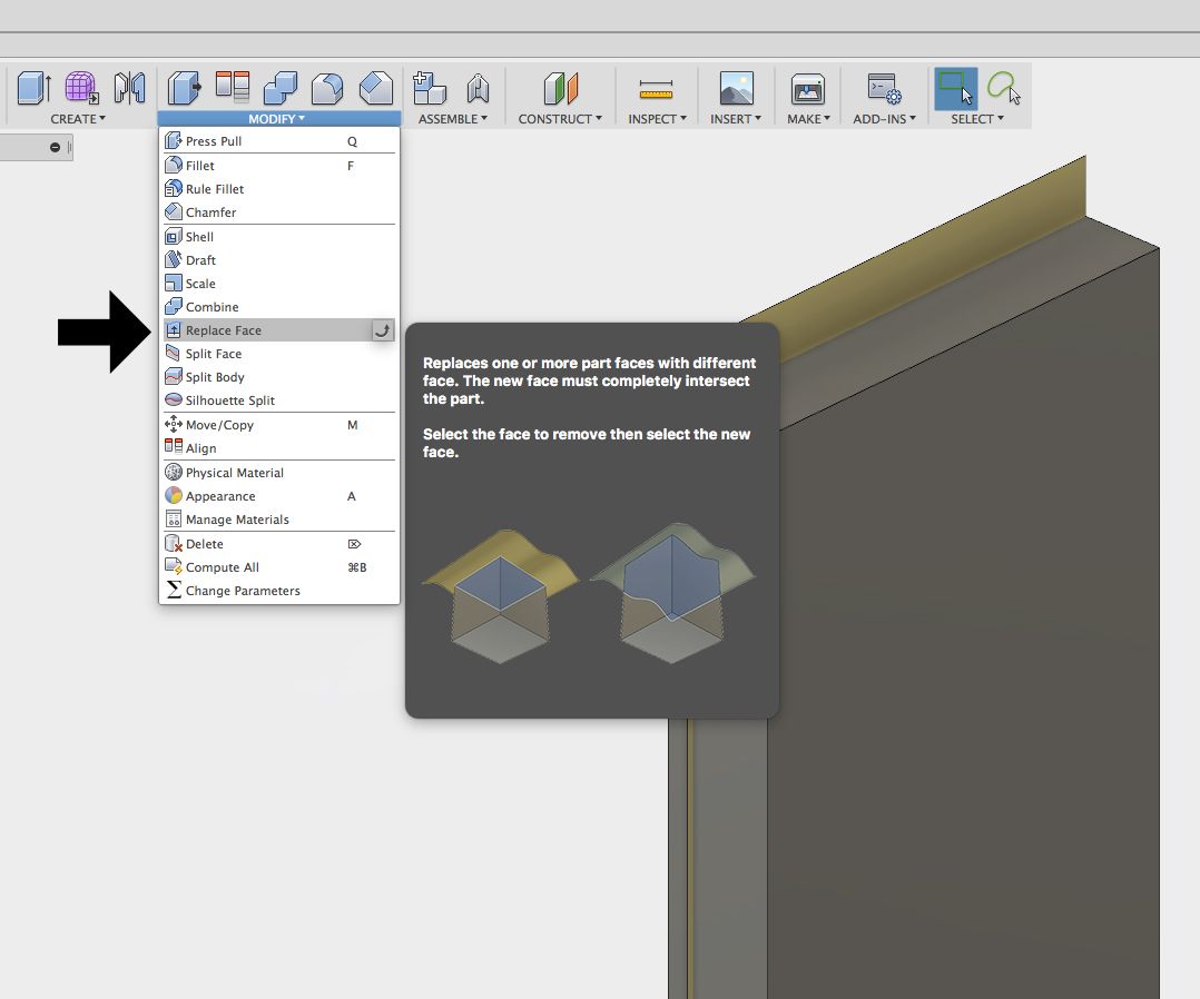

Go to MODIFY > Replace Face to cut the 3D surface out of the block you just made.
The Target Face is the 3D surface made with the script, and the Source Face is the flat face of the block that's on the same side as the positive part of the surface (the part that sticks out, not in).
You should get something that looks like this, where the 3D surface is sticking out of the block, not cut into it.

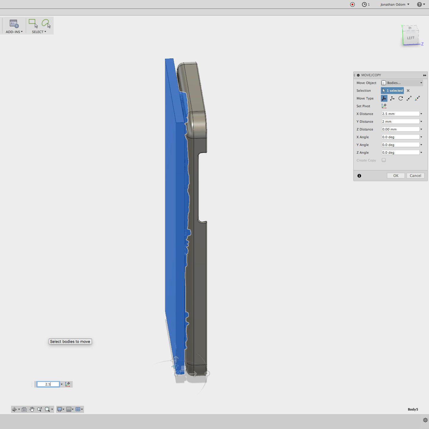

Step 8: Scale, Move, and Cut

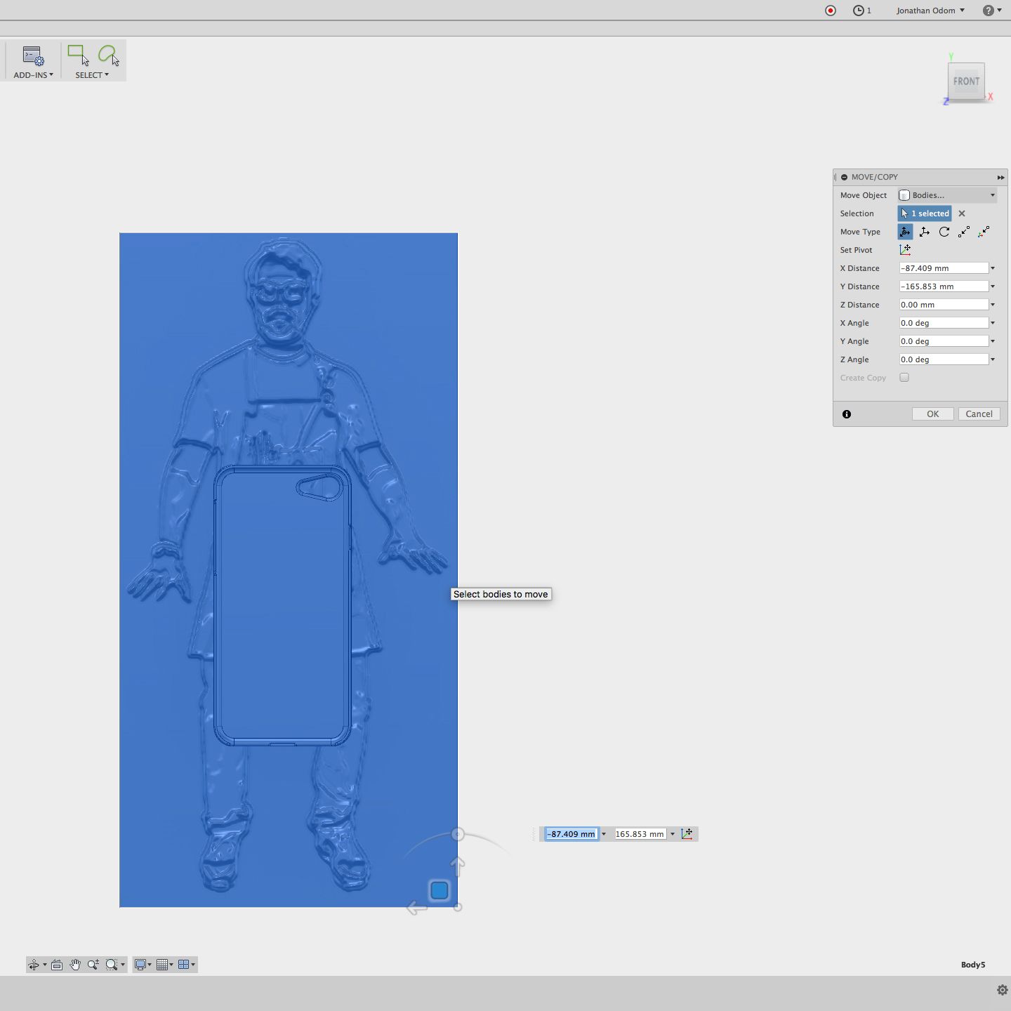

Move the new body so that it's roughly centered on the phone case.
MODIFY > Scale the body so that the picture is smaller than the flat surface on the back of the phone case.
Move it again so that the 3D surface goes into the back of the case, but leave a little bit of a gap between the flat surfaces. You might want to avoid letting the surface go all the way through the case so that it pokes out on the other side.

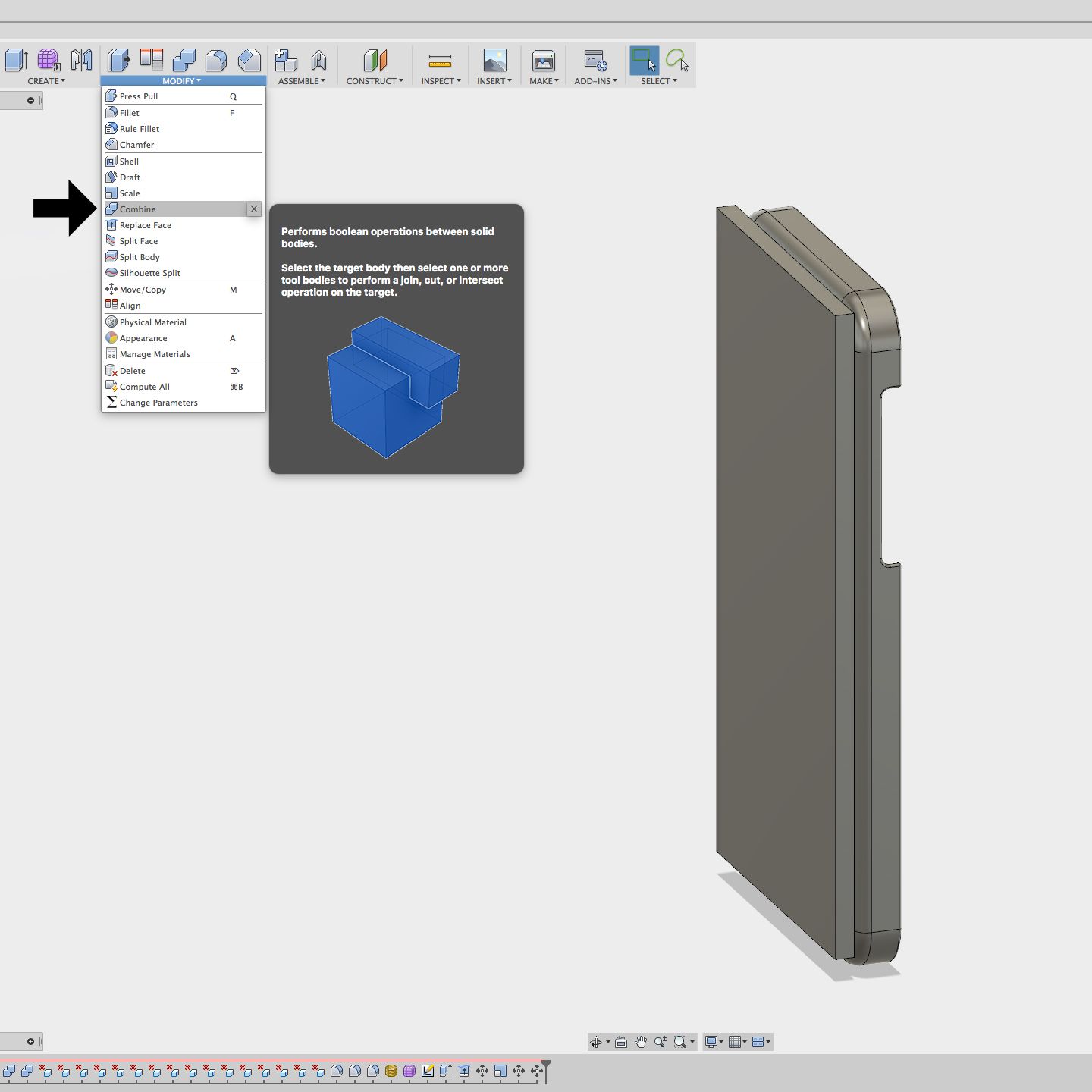

MODIFY > Combine to cut the 3D surface out of the phone case.
Target Body should be the phone case, and Tool Body should be the 3D surface.
If all goes well, you should have a 3D surface cut out of the back of the phone case.

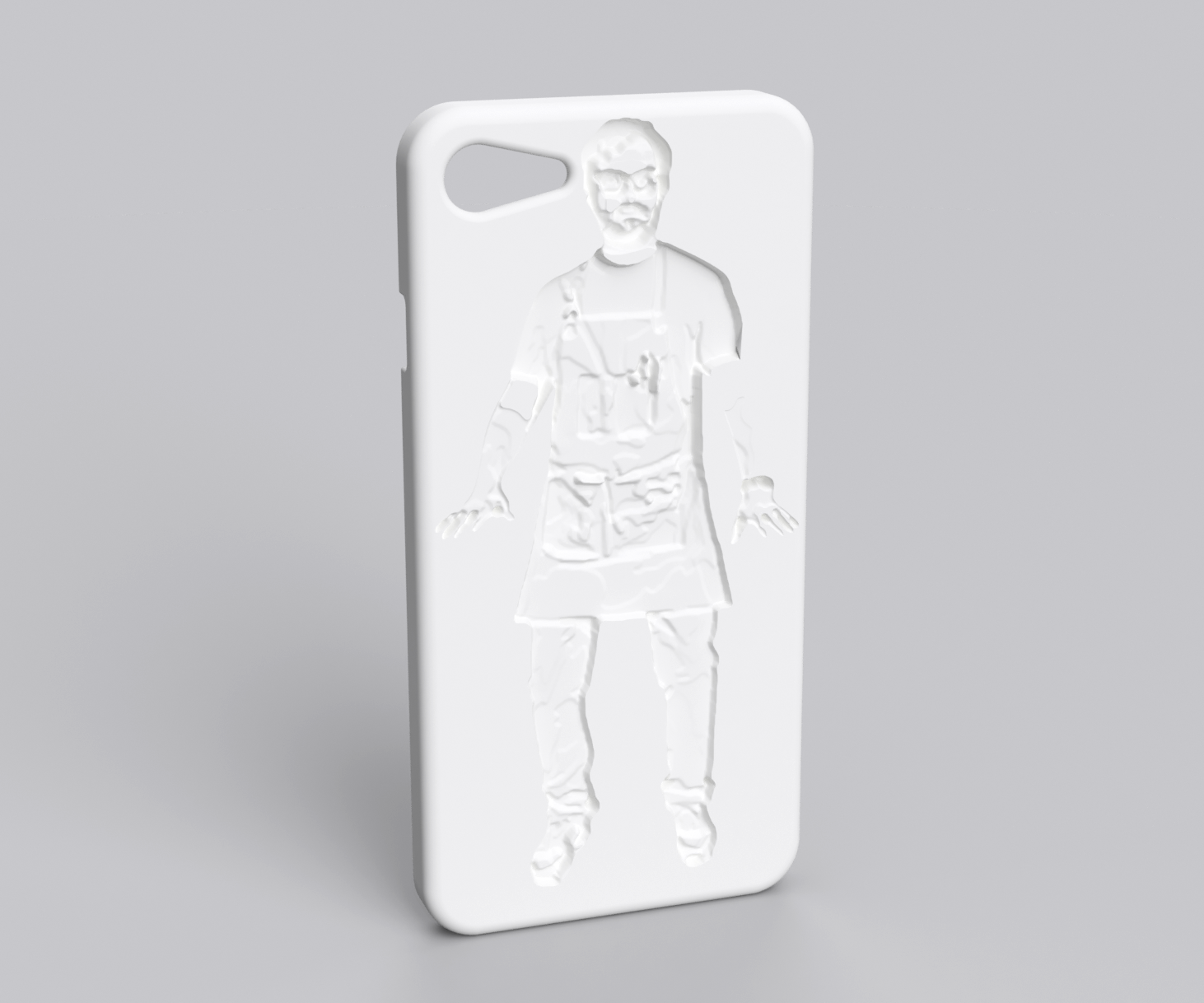

A quick rendering gives me an idea of how this will look when it's printed.

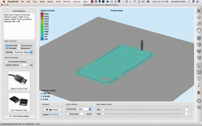

I used the default settings for PLA in Suplify 3D and printed it on my Creality CR-10. The orientation shown in the gif uses a lot of support material, but it makes for the clearest picture since it's facing up, so it's worth it.

The self-portrait came out pretty well. I can't help looking at this and thinking of Han Solo in carbonite. What picture will you use on yours?
