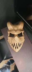

Step 1: The Mask
Due to the size of the mask and the size of the printer, it had to be made in multiple pieces and glued together. I will be using wood filler to fill in the gaps. The mouth piece moves and is held in by 2 pins (1 per side). I removed the pins by simply pushing them out to separate the jaw from the rest of the mask.

Step 6: Final Product
All in all, I am very satisfied with the outcome. By no means is it 100%, I do notice a couple flaws here and there.
