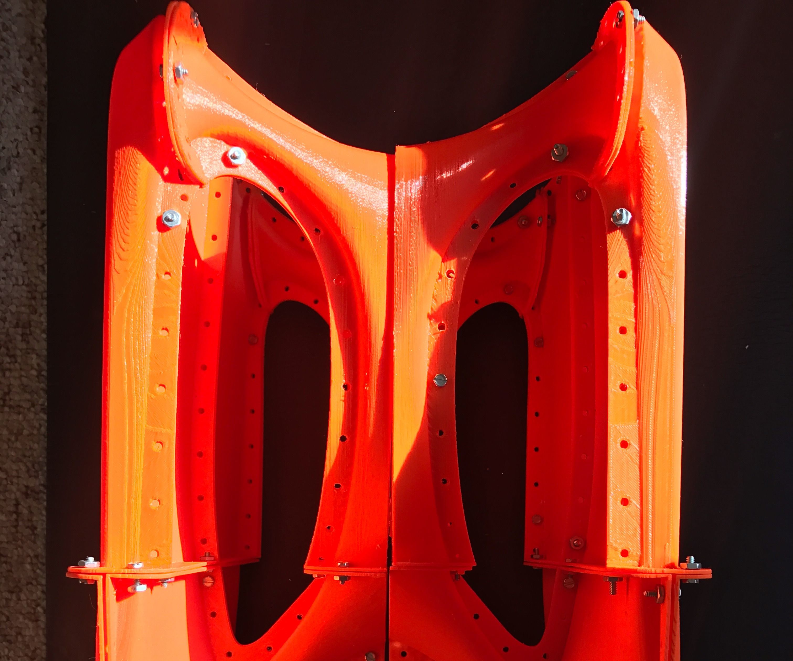

The faceted design was intended to serve as a geometry that could allow for easy mold removal with only two halves. This was also an exercise for testing surface linear relief treatment. A perforated skirt is added to both the midpoint and max convex point of the shape as well as the opening lip.

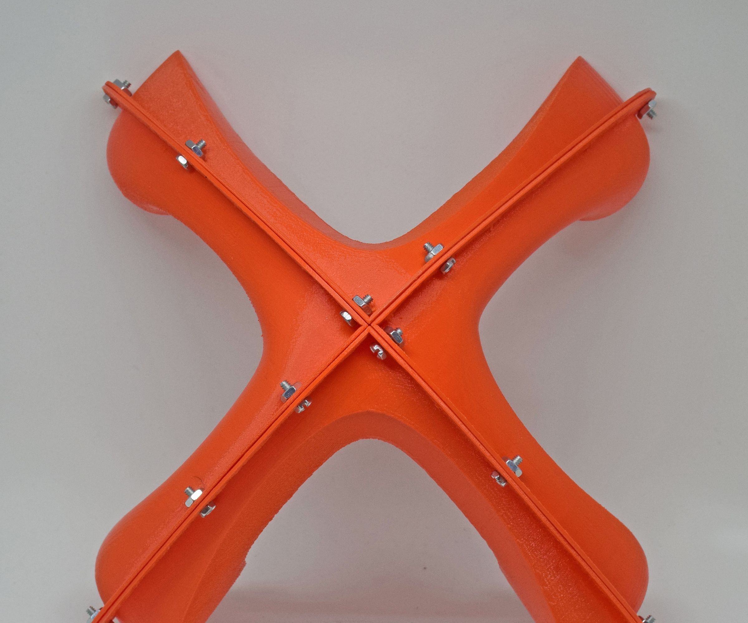

After exporting the file, the model was printed on a desktop 3D using ABS plastic. Flipping one side for both connection points to sit flat on the bed allowed for an easy print orientation that would allow for consistent line work along the whole piece.
Step 3: Test Run
I next removed the loose ends on the inside surface. Using 6-32 machine screw bolts, I bolted both halves to see the alignments of all the holes. I did not treat any of this surface nor was it sanded as I wanted to be able to see the printed ridges in the outcome.

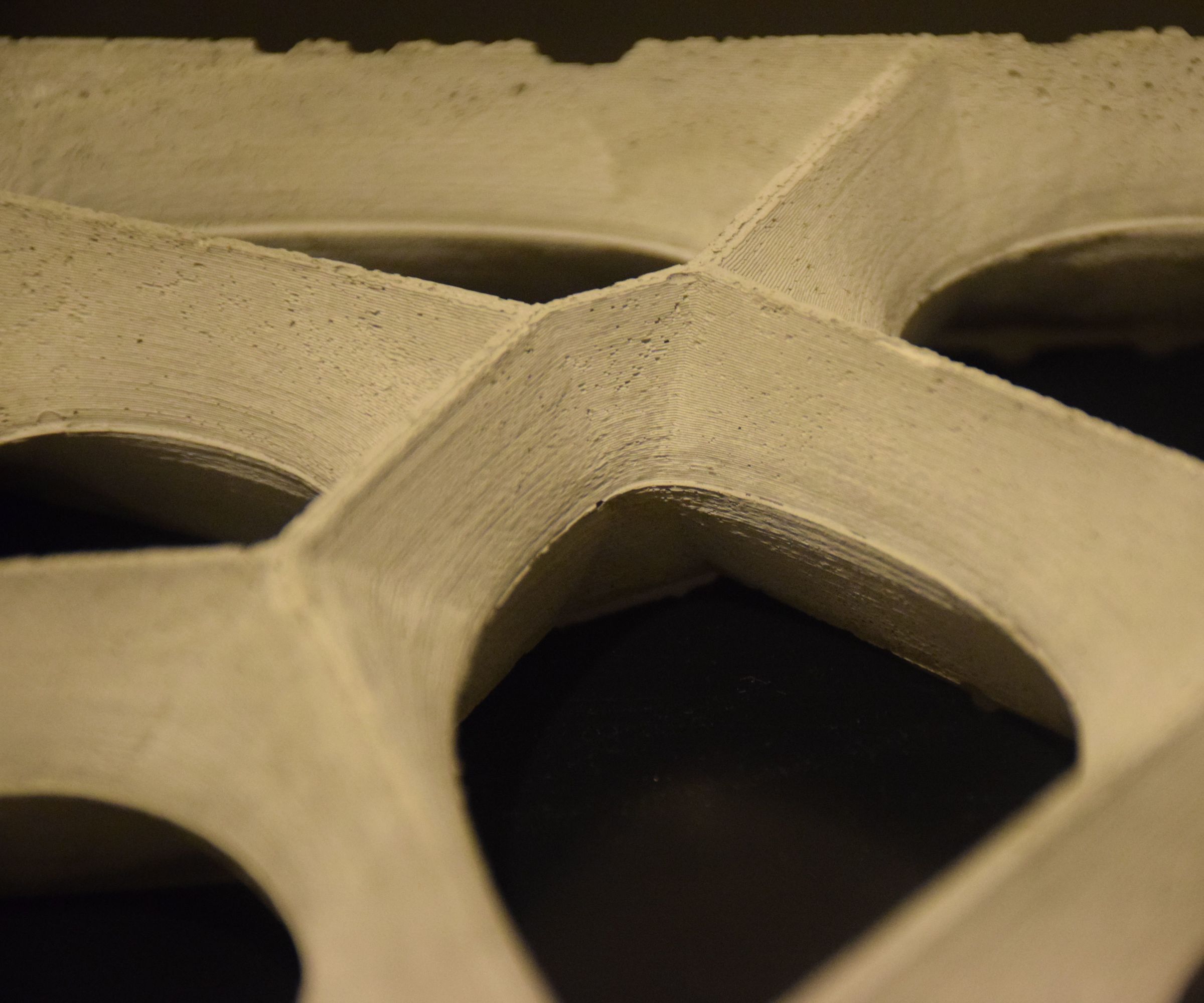

After 48 hours I began to remove the mold. Unfortunately the piece was too gripped around the concrete due to the ridges on the layered print. For this reason this mold had to be pried off the piece and ultimately destroyed.
Step 7: Final Piece
The piece continues to lose water while getting stronger after it is release from the mold. The surface line work turned out roughly how I thought though I was surprised to see how the line of connection also created a line on the piece. This could have been prevented with a more carefully glance at the 3D print file thickness at the edge. Thanks for reading and stay tuned for more Slice Lab Instructables.
