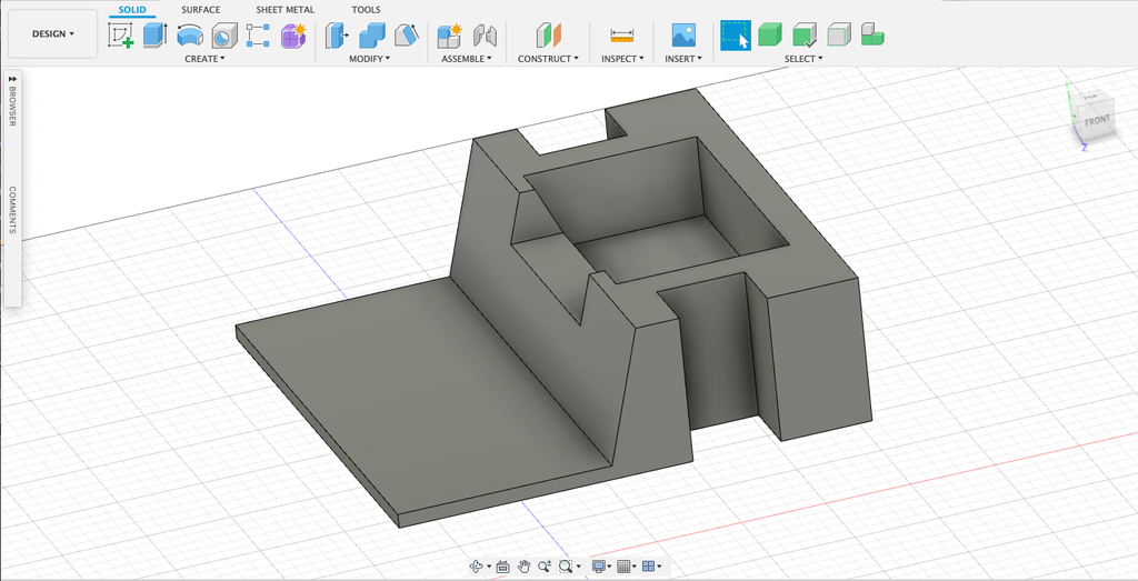

Step 4: Fusion 360: Designing the Basin Top
1. Unhide the Top layer from the Browser. Resize the height of the box to about 4 mm height.
2. Create new box that it about 44mm in height. Make the width the same as the Top and half the length.
3. Duplicate the previous box. On the front and back of the box, move the faces inwards 10mm using the move tool. Move the 2 side faces inwards 30 mm. Move the bottom face upwards 20 mm.
4. Combine the two boxes. Set the smallest box as the Tool Bodies with, the tallest as the Target Body, and the Operation as Cut. Press ok. Rename this mesh in the Browser as Small Basin.
5. Create a new box in the middle of the front wall of the small basin. A opening of about 60 mm in width by 15 mm in height is needed. Set the operation to Cut.
6. Under the Modify menu, select the draft tool. Select the top face of the resulting cut as the Plane and select the inside wall of the front wall as the Faces. Rotate the angle about 25 degrees.
7. Select the face of the rotated wall. Move it inwards about 5 mm to thicken the front wall.
8. Combine the small basin to the top mesh. Rename layer in browser if needed to Basin Top,
9. Unhide the Column Cut layer from the Browser. Mirror the column to the opposite side. Combine the two columns to the Basin Top with the Basin Top as the Target Body and the Operation as Cut.
10. Select the face of the outer part of the front wall of the small basin. Rotate the face slightly (about 15-25 degrees).
11. Select the lip face of the small basin. Rotate this face about 25 degrees.
12. Select the inside and outside edges of the lip of the small basin. Chamfer the edges about 2 mm.
13. Rotate the 3 other inside side faces of the small basin. (about 15 -25 degrees).

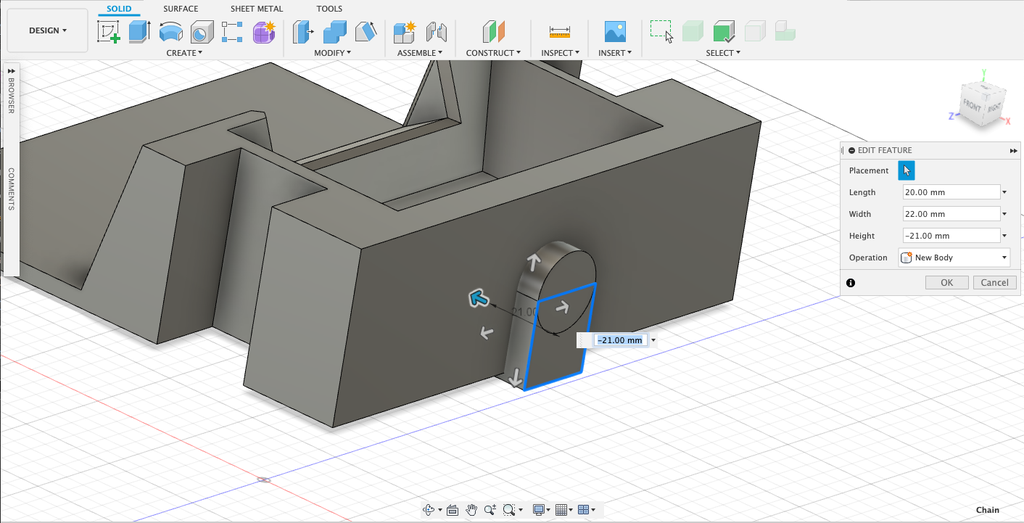

14. Create a cylinder in the middle of the backside of the Basin Top. Set the diameter to 20 mm with a 21 mm height.
15. Create a box halfway through the cylinder. Set the dimension to 20 mm x 22 mm by 21mm.
16. Combine the box and cylinder as a cut operation to the Basin Top.
17. Create a few boxes under the small basin about 22 mm in height. The goal is to make room for the PTFE tube. Combine these boxes as a cut operation to the Basin Top.
18. Use the fillet tool to round out the inside edges of the space.
19. On the side where the PTFE tube needs to filter up into the column, make a box that cuts into the underside cavity but not into the small basin.
20. Use the Fillet tool to round out the edges.
21. Make series of cylinders about 6 mm in diameter.
22. Combine the series of cylinders to the Basin Top as a cut operation to make a drainage tray.
23. Round the edges of the drainage holes about 2 mm.
24. Extrude the top of the small basin walls to create a splatter barrier (Hotkey E). Use the Fillet tool inside the Small basin to create more of a bowl shape.

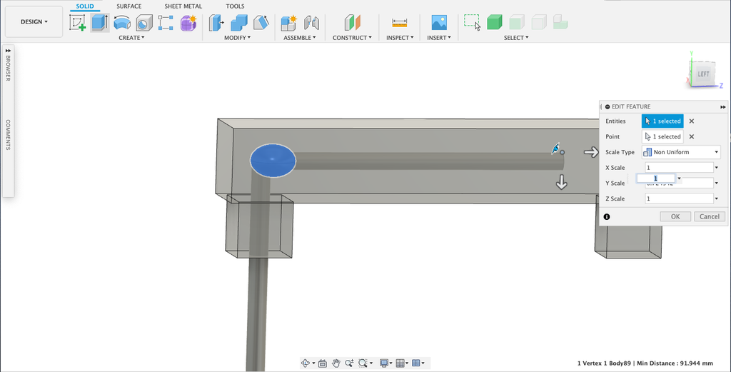

Step 5: Fusion 360: Designing the Spout
1. Create a new box (25.4 mm x 152.4 mm x 25.4 mm) a top of the columns of the basin. This needs to stretch from column to column. Name this box Spout in the Browser hierarchy.
2. On the left side of the spout, create a cylinder with a 6 mm diameter with a 104 mm height. Center the cylinder so it is in the middle of the spout and 12.4 mm from the edge.
3. Unhide Spout Post from the Browser. Mirror the Spout Post to the opposite side and join both posts to the Spout using the Combine tool.
4. Create a new cylinder in the middle of one of the posts on the side the PTFE tube needs to be on. Set the diameter to 6.5 mm. Align the new cylinder to intersect with the horizontal.
5. Create a 15mm Sphere. Move the sphere to cover the intersection of the two cylinders.
6. Under the Modify menu, select Scale. Select the sphere and set the scale type to Non Uniform. Scale the y axis to about 0.72mm.
7. Select the sphere and the horizontal cylinder. Move the objects so the horizontal cylinder is about 5.7mm from the bottom of the spout edge.
8. Combine the two cylinders with the sphere. Use the Fillet tool to round the edges leading into the sphere.
9. Combine the inside tubing to the spout as a Cut operation.
10. Create a 2mm cylinder at least 15mm in height. Move the cylinder to intersect with the horizontal tube inside the spout. Duplicate the vertical cylinder and move it to the side 8mm. Repeat duplicating and moving cylinders 5 more times.
11. Combine the 7 vertical cylinders to the spout as a Cut operation.
12. Using the Fillet tool, round out the inside edges of the vertical openings.
