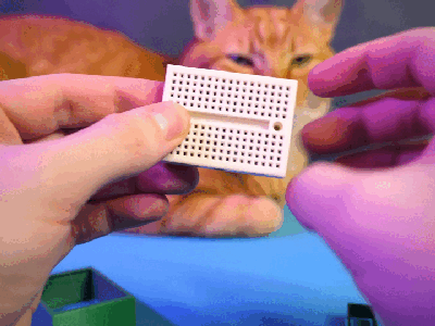

I thought it would be a good idea to have a small breadboard with the rechargeable battery inside.
3D print the small breadboard holder. Trim off the sides of the breadboard so it can drop in the main frame. Place the battery frame followed by the battery holder. Finally slide in the lid which I designed to snap and hold in place.
