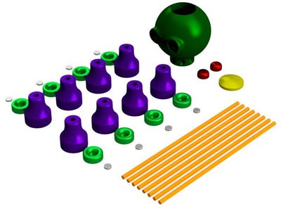

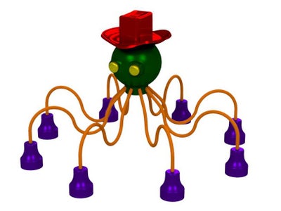

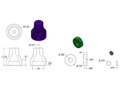

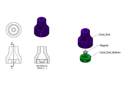

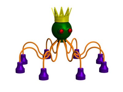

Step 1: Design
This step shows CAD images of the design. Refer back as needed when working on the build.
Step 2: Print Parts
Print files. You will need:
  1. Head (x1)
  2. Hat - multiple to choose from
  3. Cord_End (x8)
  4. Cord_End_Bottom (x8)

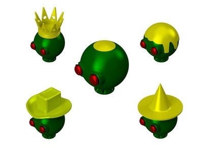

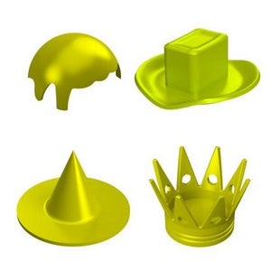

Step 3: Hats
I decided to give the Octopus multiple options for hats. The design is interchangeable, so you can print various possibilities:
  1. Smooth
  2. Hair
  3. Cowboy
  4. Witch
  5. King

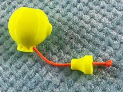

Cut 8 pieces of paracord to 10" long. Use a lighter to clean up the ends. While still in the melted state, pull a wet rag across the ends to remove the melted ball. This is important since the cord needs to fit through small holes.

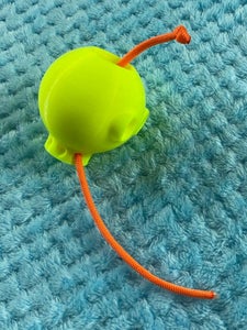

Step 5: Feed Paracord Through Head
Feed the cord through the head. Tie a knot. This prevents the cord from pulling back through the hole. Trim excess material.
Step 6: Feed Paracord Through Cord End
Feed the cord through the Cord End. Tie a knot. Trim excess material. Repeat 7 more times.

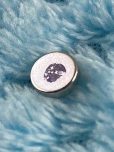

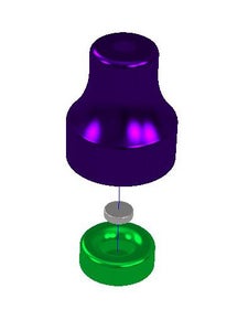

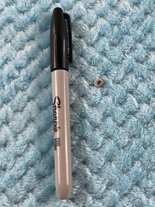

Step 7: Mark Polarity of Magnet
Take your time on this step. Mark the magnet's polarity before pressing it into the printed part. This is important if you want the magnets to stick together (vs. repel) later. For my build, I ensured that all eight legs would stay together with matching sets of magnets.

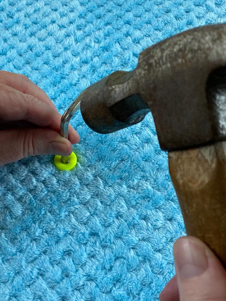

Step 8: Add Magnet
The magnets should be an interference fit with the Cord_End_Bottom. I used an Allen wrench and hammer to push the magnet to the bottom of the part.
Step 9: Bottom Attachment Cord Feed
Attach Cord_End_Bottom to Cord_End. Depending on your printer/settings, this could be an interference fit. Mine was slightly loose, so I used superglue for the attachment.
