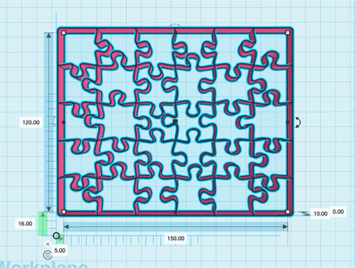

Step 5: Convert the Puzzle Design for Tinkercad (or Other Program)
Alright, here is the big, important part of this tutorial.

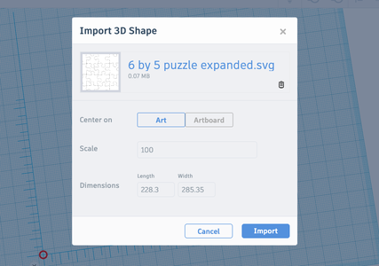

Now that you have your SVG, we need to make the lines a little bigger before bringing it into Tinkercad.
In its current state, if you bring it in, it will likely look something like the first photo above because the lines are too small for the program to handle, not only that, but the lines are going to be too thin to print. So, we need to use another program to do a little editing.
I am using Inkscape (Illustrator or another program should work as well) so these directions are specific to that program, but this should give you an idea.
Take the SVG and open it up.
  • Make sure you have selected your puzzle object
  • Click on the PATH menu at the top of the screen
  • Change the line thickness/width to .15 mm
  • Click Stroke to Path
  • Double check to make sure it is no longer a line and is now a path
  • Enlarge (optional) to make sure you get good curves when you import it (I've noticed in the past that when you bring rounded/curved objects into Tinkercad, the smaller they are the more likely the smooth curve is lost so I enlarge things and that preserves the curve) - also make note of the size BEFORE enlarging to make sure you can resize it correctly later
  • Import into Tinkercad as large as you can (again for best detail)
  • Shrink to the size you made note of earlier
Now you have your puzzle shape that you can cut your puzzle design with.

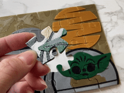

Once it's done, it's time to pop those pieces off! As I mentioned, a little fusing can be okay, you'll just have to break those pieces apart. Carefully bend them back and forth at the connection (last three images above) until they snap apart.
Step 10: Enjoy Your Puzzles!
My daughter seemed to have fun with these :)
Step 11: Baby Yoda / the Child / Grogu and the Mandalorian
