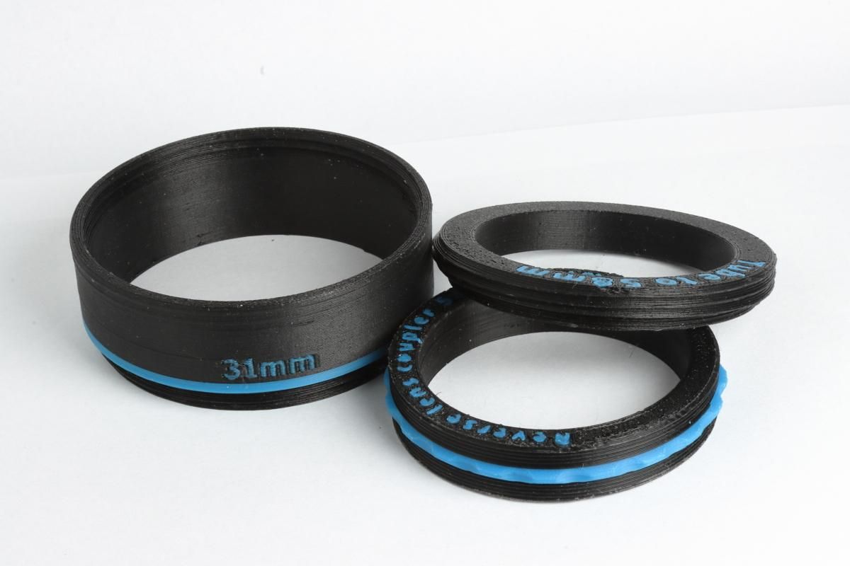

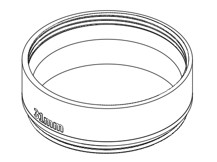

You don’t need to have a multi-colour 3D printer to print these files. You have three choices with the files provided;
  1. Single colour: Choose the standard file
  2. Two colours: Choose the file with the “SC” suffix. Break apart and assign colour as per your system.
I have labelled the adaptors because they will sometimes be hard to tell apart. You’ll notice that the text quality is poor. Sadly the resolution of FDM printers limits text to a minimum of 5mm height, and I only had 3.5 to a maximum of 5mm of space. However, after testing, I found the text to be still readable, though not always easily (blue on black doesn’t help), so I have gone ahead with it. My apologies for the readability aspect. A better colour contrast will help.
