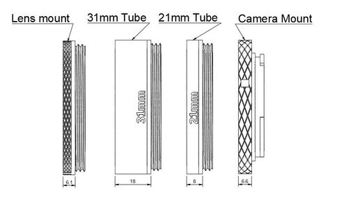

Step 1: This Macro Kit
The kit has three sections that screw together. Since each section has several interchangeable options, their combination makes the kit capable of solving a large range of problems.
- Camera mount (EF and EFs lenses)
- Tubes (21mm and 31 mm)
- Lens adaptors (Forward and reverse mounted)

Step 4: Kit Parts: the Standard Tubes
The standard tube set gives you effectively four extension choices.
| Components in addition to camera mount + lens adaptor | Effective length for calculation | |
| 1 | Nothing | 13mm |
| 2 | 21mm tube | 21mm |
| 3 | 31mm tube | 31mm |
| 4 | 21 + 31mm tubes | 39mm |
Tube lengths explained
If you screw the camera mount and lens adaptor together, they move your lens away from the camera 13mm. The tubes move the lens away from the camera the distance indicated on their label; that's why I call it the 'effective' distance, as it's not the actual length of the tube. The effective distance in the table above is what you should use in your calculations.
