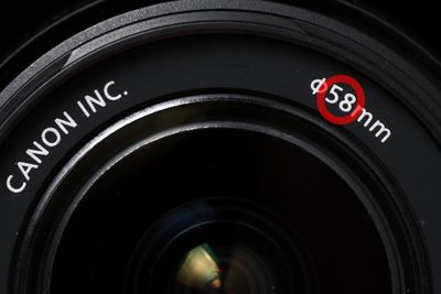

The Adaptor File
lens front with filter size
To choose the correct file, you'll need to know the lenses filter size. You can find the filter size printed on the inside of the front of your lens.
The diameter symbol, 'ø', precedes the number you need, which is followed by "mm."
Use the file that matches your lens. Filenames
