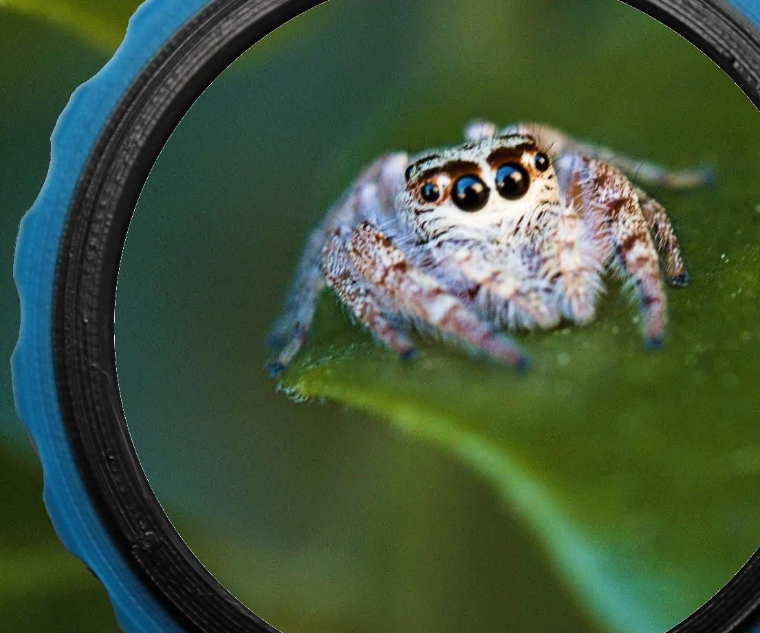

Step 1: Coupled Reversed Lenses
With the Reversed Lens Adaptor (Lesson #2), we could mount a lens back to front and use it as a Macro lens. However, we can improve this design by mounting a long lens on the camera and use the Coupled Reverse Adaptor to reverse mount a shorter focal length lens to it (See Diagram above.). Why do this?
  1. Control is better. The 'rear lens' is connected to the camera's electronics which means we can control it.
  2. The quality is better. (A single reversed lens can be soft in the corners)
  3. The magnification is higher. The non reversed lens is acting as a tube extender
You can get a rough idea of the magnification by dividing the long focal length by the shorter one. In my case, I used the 250mm end of one zoom and the 18mm end of the other, giving me an astounding 14:1, though this is likely to be less in reality
More details about reversed lenses and their application are available here and here.
Please note how I refer to each specific lens in the diagram above, as I'll use these terms in this lesson.
  • The 'rear' lens is the one closest to the camera
  • The 'front' lens is furthest from the camera.

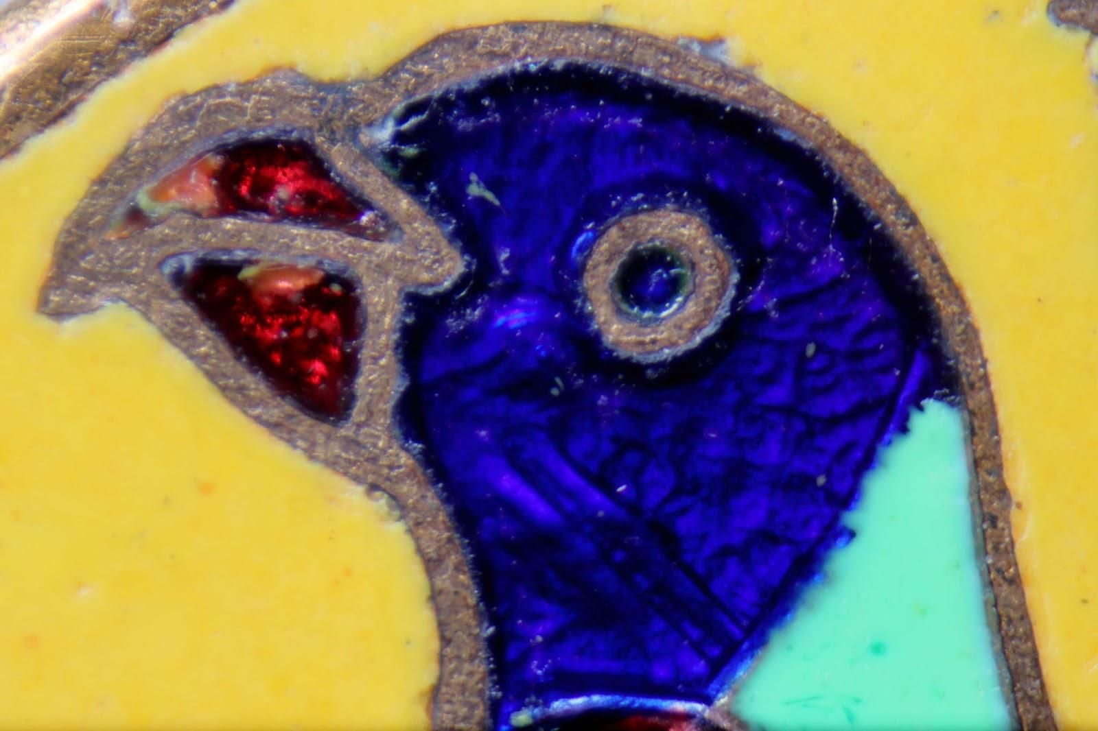

Step 2: What Can You Expect With This Adaptor?
No adaptor
  • Lens: 18-55mm zoom
  • Focal length: 55mm
  • Content approximately 24mm height
This is the kit lens zoomed in as much as I could. While not promoted as a macro lens it performs well closeup.
Single reversed lens
  • Focal length: 18mm
  • Content approximately 4mm height
This image is from the last lesson. It's about a 3:1 magnification
Coupled reverse lens (50mm)
  • Lens: 50mm prime + 18-55mm zoom
  • Focal length: 18 and 55mm
  • Approximately 3.5mm in height
There is only slight enlargement (3:1) compared to the single reverse. Notice that it is sharper
Coupled reverse lens 55mm
  • Lens: 18-55mm and 55:250 zooms
  • Focal length: 18 and 250mm
  • Approximately 1mm height
By using the 18mm end of one zoom with the 250mm end of the other, I get about 12:1
enlargement. However, as you can see, the image is beginning to lose some clarity. An AI sharpening algorithm may be able to claw a little back.
