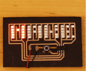

I made the LED matrix display circuit using the same software process as in the LED Art instructable. It took me about 7 iterations to get this circuit right, but since I could print out each iteration in about 20 minutes with the Electrifi filament, the optimization process was pretty quick. I used the 5050 LED package again, but I removed the two middle pads from the package since the WS2812 doesn't have those. Also, I made some screw-type terminals to make better contact between the wires and the Electrifi Filament. Above are pictures of the finished circuits and here is the software files. The matrix on the left is pretty close to the smallest (77 by 117 mm) that can be made reliably, while the matrix on the right is about the biggest (120 by 144 mm) I can make with our 3D printer.

Just like normal LEDs, the WS2812B RGB LED has to be wired up with the right polarity (connections to positive and ground) for it to work. See the picture of the WS2812B with its pins labeled. Unlike normal LEDs, you can't just apply power to the WS2812B and have it light up, you have to send a string of voltage pulses through the data pin in order to tell it the intensity and the color of light you want.
Now take a look at the picture of the completed neopixel matrix display. To place the LEDs, I used a solder reflow tool to heat up the pads before squishing the LEDs into the Electrifi Filament, just like in this LED nametag video. Note that for each column of LEDs, the direction of the ground alternates from top to bottom. You can see this in the image because the black microchip, which is on the ground side of the LED, switches which side of the LED its on from column to column. This is to allow the data line to snake in an S pattern back and forth across the circuit, allowing for the printing of an LED matrix display in a single layer. This data connection between the LEDs allows you to control their color individually with a microcontroller, but if one LED is placed the wrong way and the data line is cut, all the LEDs after that cut won't light up. So be careful!
After placing the LEDs, I hooked the matrix up to a lithium polymer ion battery for power, and an Arduino nano as the microcontroller. For other power options, see the Neopixel Uberguide. The Arduino and matrix share the same connections to power and ground where they are sandwiched between two nuts around #6 bolts that I poked through the poster board. The washer on the front of the poster board ensures a low-resistance connection between the filament and the bolt. These bolts are a great way to connect the wires from a battery or external circuit to the printed circuit with a much lower resistance than is possible than just sticking the wire into a pad of filament, as demonstrated in our Electrifi FAQ. I highly recommend this connection method wherever its feasible, it works great with smaller bolts as well. Lastly, connect the output pin used from the Arduino to the data line of the matrix display in the same manner. Its not a big deal if you happen to make these connections in a different order.
