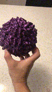

Bring the microscopic world of proteins to the macro scale. With this tutorial you can convert any protein surface into a 3D printed object. Before you would be limited to structures with solved crystal structures, but now with AI "solving" protein folding, almost any structured protein is a click away.

I use PrusaSlicer, to convert the 3D model into 3D printer instructions. Import your stl file (drag and drop), rotate it it if necessary to select a flat print surface.
There's no single correct choice for 3-D printing or slicing parameters. Many factors may influence practical and aesthetic considerations of your print. For a hand-held sized virion ( height: 150mm), printed with regular filament (material: Silk PLA dual-color filament) I found the following settings helpful
Nozzle Size: 0.4mm
Layer Height: 0.1mm
Perimeters: 4
Thick Bridges: True
Supports: Organic
Infill: Lightning, 10%
