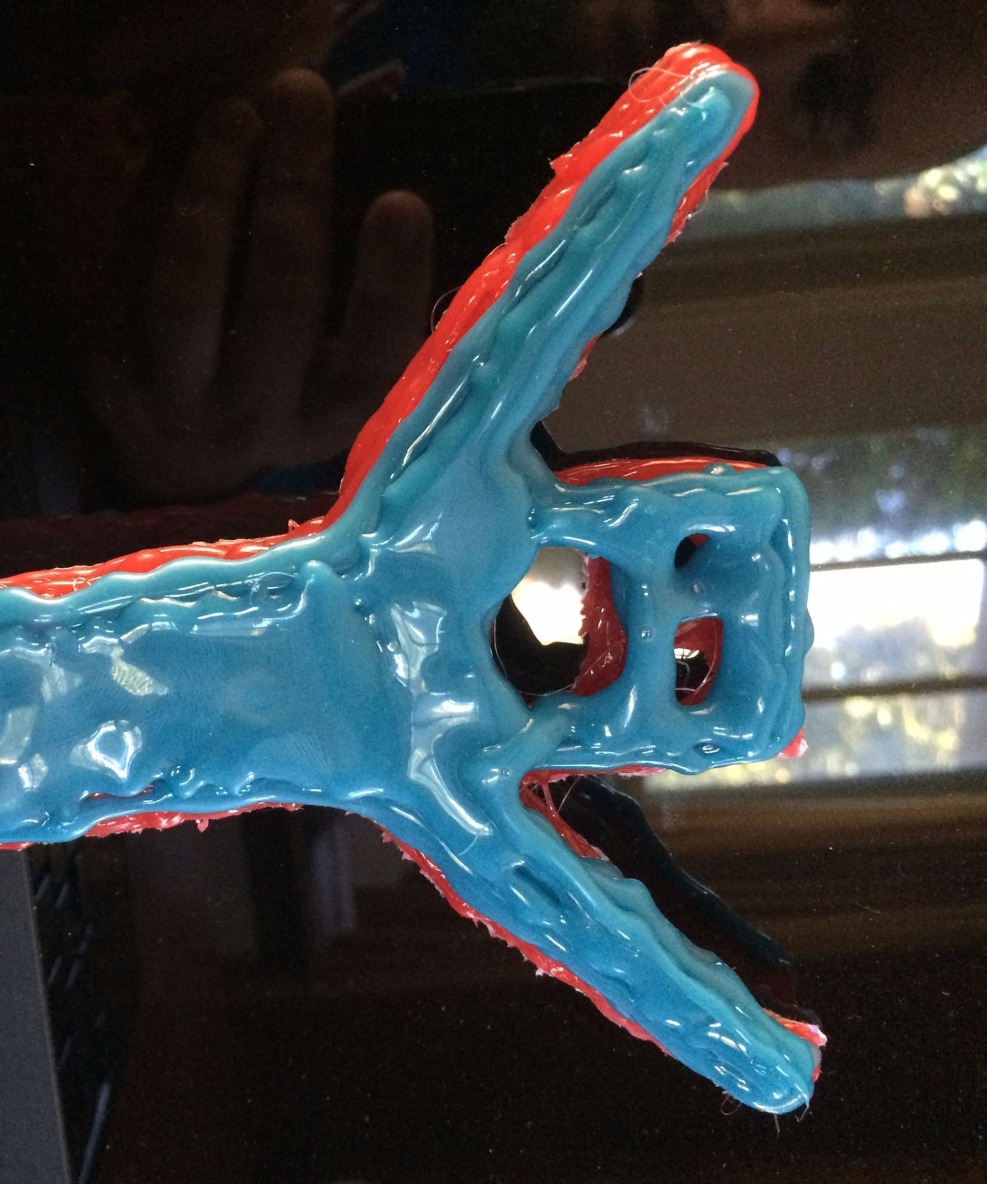

It can be tricky to get these models to print as they have features like circular overhangs which can be challenging for some printers. Additionally, they tend to have a small base so you may want to add something to the bottom of the model using your printer's software to make sure it doesn't break loose from the bed while printing. You can see in my example that this print challenged my printer.
