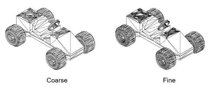

But,if you consider the idea of converting a perfectly rounded sphere into triangles. The resolution of your .stl file is in contrast to the larger triangles. On the contrary.
But why? We have a major reason to consider controlling this setting and this is because it can directly affect the quality of your printed 3D model. If your settings are too high compared to the resolution of your 3D printer, the printer will be able to print the definition of triangles and your model will be able to move away from the size of your intended design. If you have made your model too fine, you will not suffer from low quality models, chances are you will have a large file that will take a long time.

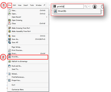

You can use Print3D to print 3D prototypes of your models when you have a 3D printer installed locally.
To access a local 3D printer, in a part or assembly document click File > Print3D. or you can search print3d

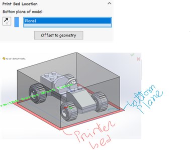

Step 6: Print Bed Selection
First select the bottom plane of your model that will be on the printer bed.

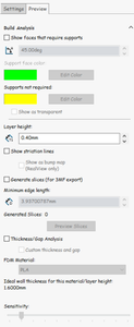

Step 12: Build Analysis
In this section you can see the part of your model needs support to print.
by assigning different color it shows beautifully.
also you can enable show as transparent to look through the model.
Step 13: Viewing the Layers
One of the cool thing is it also mimic the layers according to specified layer height which is also the extrusion size also. If real view graphics enabled, it can produce the bump map for the layers.
Step 14: Slice for 3MF
You can also see the slices for 3D Manufacturing file
Step 15: Thickness/Gap Analysis
One of the most benefited feature is analyzing thickness and gap according to material.
It shows if a thickness or gap can be created or not according to applied FDM material.
