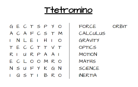

The most straightforward way to play ⏊E⏊RAMINO ⏊WIS⏊ is to create a word puzzle based on a specific theme. For instance, you could choose "famous scientists" as your theme and associate words like "apple," "force," "calculus," "gravity," "optics," "motion," "prism," "maths," "science," "inertia," "orbit" for example, with Isaac Newton.
The game requires at least two participants: a puzzle creator and a solver. The puzzle creator selects 6-8 words from the themed list and arranges them on the board, either horizontally or both horizontally and vertically. The remaining spaces are filled with blank tiles or additional letters, as shown in the photo. The creator then disassembles the board into its T-tetromino components and presents them to the solver.
The solver's task is to reconstruct the original board by correctly positioning the T-tetrominoes and deciphering the hidden words. As mentioned earlier, the tiles can be placed on the side of the board with the pre-printed arrangement (easier) or on the blank side (more challenging).
The solver may or may not be informed of the theme beforehand. Discovering the words and deducing the theme can be part of the challenge, adding an extra layer of engagement. To extend gameplay, the puzzle creator can prepare multiple themes with corresponding word lists. This is especially beneficial if the game is intended for children, as it can be a fun and educational activity led by a parent or educator.
Another game variation involves creating a "wordsearch" style puzzle using as many words from the original list as possible. Several online tools, such as the Word Search Maker, can help generate such puzzles. In this variation, an additional goal would be to find all the hidden words on the board.
