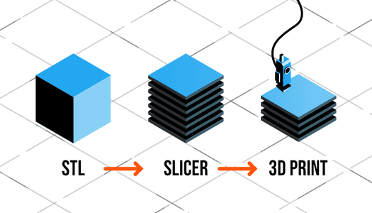

There are 3 stages in 3D printing.
1 The 3D model as a STL file
2 Slicing the STL into instructions for the 3D printer, regarding the order that the layers should be printed in.
3 Sending the slice to the 3D printer
